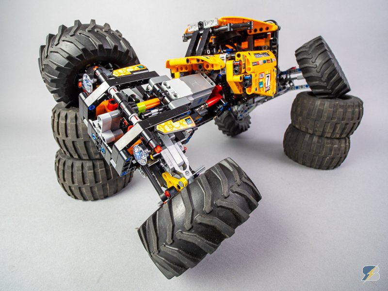

Here is a video showing how the front and rear axles communicate and how the center module averages between them.

Finally did a real slope test. The default longitudinal tilt angle is 3 degrees (leaning forward) and the max tilt angle in a climb is 44 degrees (leaning backwards), so overall it can climb 47 degrees, which is about 107%.
Not quite as fast as my previous buggy :wink:https://youtu.be/ek-_36MBD9k
Edited by Didumos69
You are not at the limit yet, just the limit of traction on that surface, do it again on a more grippy surface, when it tips over backwards, then you have found it.

@kbalage when you locked the diffs, the steering was not very good?
Steering is fairly limited with and without diff locks. Max 20 degrees I think. The reason for that is explained in the OP.
There was some difference on flat surface but on the rocks it was not really noticeable.
