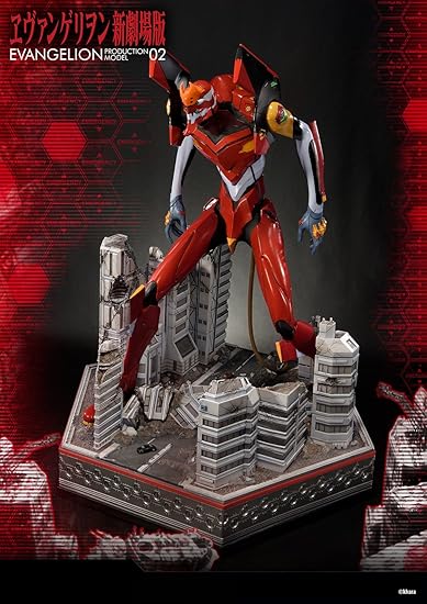

I got the idea to make a base diorama from a huge and beautiful display model by Prime 1 Studio, below. Unlike Unit 02 itself, my Tokyo-3 diorama is not a one-on-one recreation of any specific part of the city as seen in the anime. I paid close attention to the civil infrastructure, though.
