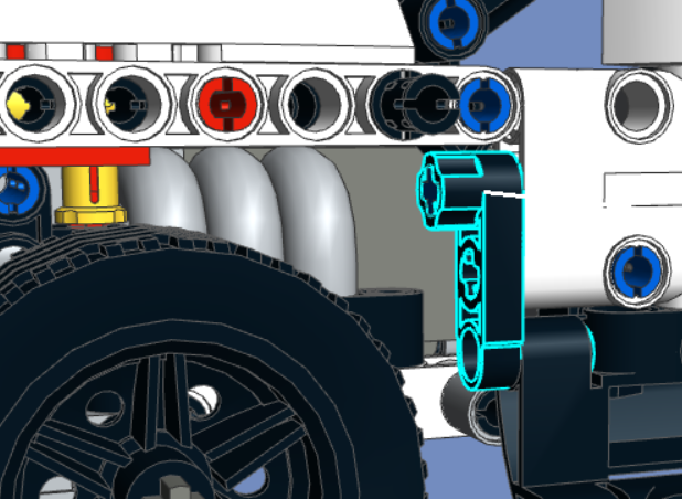

Ngoc Nguyen Posted January 21, 2020 Posted January 21, 2020 I've just finished building this set. Overall a very enjoyable build. There's a little problem with steering though. Apparently there is no kind of steering limitors, so when I steer the model to the maximum to either side, the front wheel will rub the wheel arch in the back and cant rotate. Does anyone encounter this problem? Quote
kbalage Posted January 21, 2020 Posted January 21, 2020 @Ngoc Nguyen check if the highlighted piece is in correct position and it's not upside down, there should not be rubbing normally: Quote
Ngoc Nguyen Posted January 21, 2020 Posted January 21, 2020 17 minutes ago, kbalage said: @Ngoc Nguyen check if the highlighted piece is in correct position and it's not upside down, there should not be rubbing normally: Mine is in the correct position. The wheel doesnt rub there though. It rubs the wheel arch in the back. Quote
kbalage Posted January 21, 2020 Posted January 21, 2020 @Ngoc Nguyen a photo would help to identify the issue. Normally there's always ~0.5cm gap between the front wheels and the wheel arches, regardless of the position of the wheel. Quote
Ngoc Nguyen Posted January 21, 2020 Posted January 21, 2020 34 minutes ago, kbalage said: @Ngoc Nguyen a photo would help to identify the issue. Normally there's always ~0.5cm gap between the front wheels and the wheel arches, regardless of the position of the wheel. Quote
kbalage Posted January 21, 2020 Posted January 21, 2020 @Ngoc Nguyen you need to turn your wheels, the other side of the rim should be facing outwards. Quote
Ngoc Nguyen Posted January 21, 2020 Posted January 21, 2020 Just now, kbalage said: @Ngoc Nguyen you need to turn your wheels, the other side of the rim should be facing outwards. Now that makes more sense. Thanks a lot! Quote
