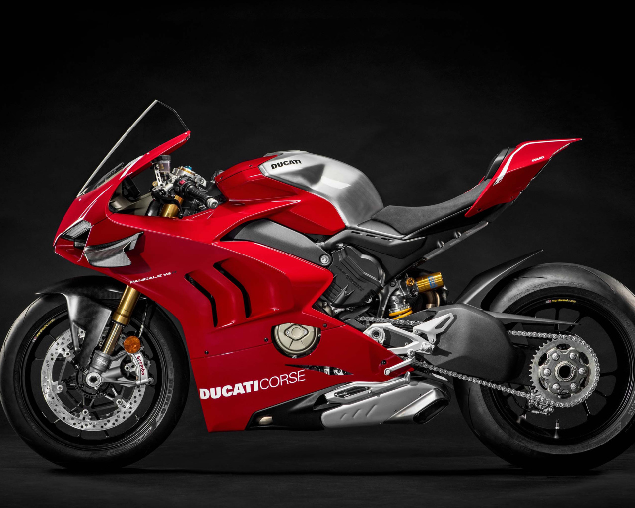

therealjustin Posted May 20, 2020 Posted May 20, 2020 Ducati actually switched back to a more conventional suspension with the V4, V4S, and V4R. Quote
Void_S Posted May 20, 2020 Posted May 20, 2020 4 minutes ago, therealjustin said: Ducati actually switched back to a more conventional suspension with the V4, V4S, and V4R. Yes, it's likely-vertical mounted single shock absorber with yellow sprung. Possibly, the real-life model also have no space for other suspension geometry due to oversized engine: Quote
agrof Posted May 20, 2020 Posted May 20, 2020 47 minutes ago, therealjustin said: Ducati actually switched back to a more conventional suspension with the V4, V4S, and V4R. Thanks for the info, for some years I am out of the motorcycling world, so did not follow up the model evolution. What a beast... I wouldn't dare to drive it, though I had a ZRX1200R for some years (it was a very friendly monster). Quote
