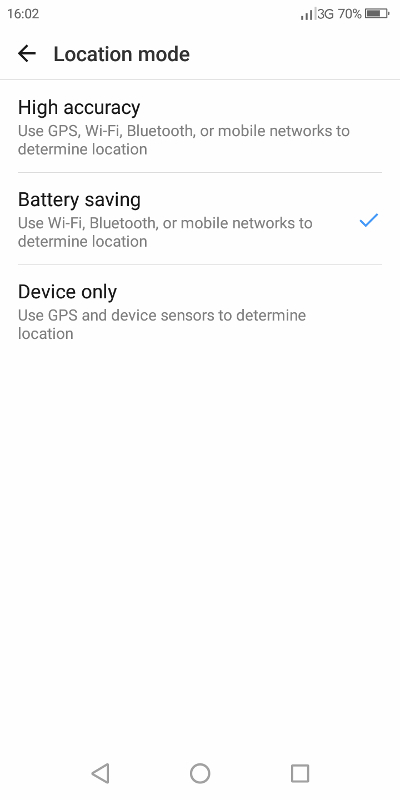

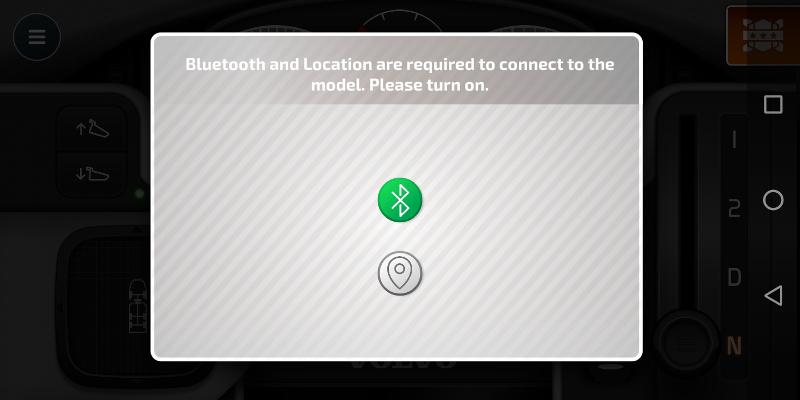

dr_spock Posted January 21, 2021 Posted January 21, 2021 I finished bulding the 42114 Volvo Hauler and ran into a problem. The Control+ app wouldn't detect that location is enabled when location mode is set to Device Only. Yet the Powered Up app worked fine with location mode set to Device Only and could connect to the Technic Hub and updated its firmware. After some head scratching WTFs, I found changing the location mode to Battery Saving or High Accuracy on my Android phone got Control+ to see location is turned on. And I could play with the 42114. Why is that with Control+ app? I took out my 42030 Volvo Wheel Loader, put some batteries into the PF battery box and PF remotes. It worked loading bricks into the Volvo Hauler without any use of colourful vomit language. Quote

TechnicRCRacer Posted January 21, 2021 Posted January 21, 2021 3 hours ago, dr_spock said: High Accuracy on my Android phone got Control+ to see location is turned on. And I could play with the 42114. Why is that with Control+ app? It seems all apps want to use your location now for online connecting services, probably for region. I ran into this with another app that demanded I use high accuracy setting. Quote
