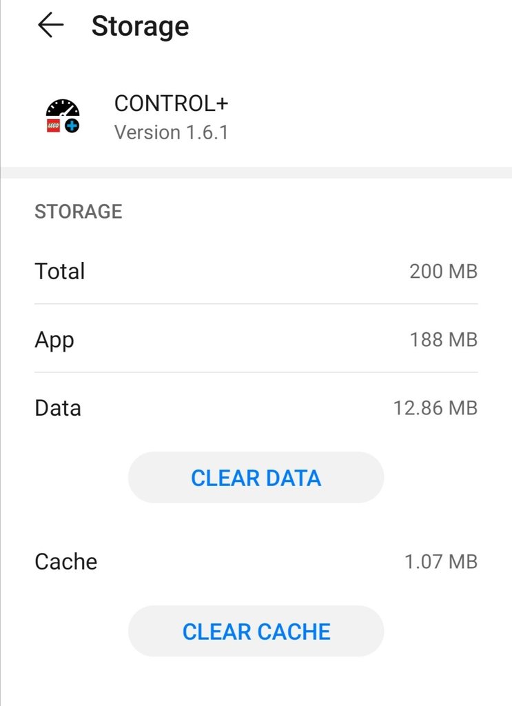

leonema Posted February 6, 2022 Posted February 6, 2022 (edited) 31 minutes ago, kbalage said: That's not how Android permissions should work. Once you clear the app's data and reinstall it, you need to grant access again as the previous settings are also deleted. If you correctly delete the app's cache and local data, that should trigger the permissions popup on next launch (when you open the set's profile in the app) even without reinstalling it. usually i force kill then clear cache, then clear data my app version is also 1.6.1 and have android 11 RPES31.Q4U-47-35-11 just tried again... same result... no permissions popup it's all very weird... because controlz and even lego powered up work perfectly... here the screenshot and the permissions screenshot bluetooth, location and wifi are turned on... Edited February 6, 2022 by leonema Quote
JaBaCaDaBra Posted February 6, 2022 Posted February 6, 2022 1 hour ago, leonema said: usually i force kill then clear cache, then clear data my app version is also 1.6.1 and have android 11 RPES31.Q4U-47-35-11 just tried again... same result... no permissions popup it's all very weird... because controlz and even lego powered up work perfectly... here the screenshot and the permissions screenshot bluetooth, location and wifi are turned on... At Adroïd 11 you get the permission setting choices, ALWAYS and WHEN USING THE APP It's neccessairy that you set to ALWAYS or the app won't work. Quote
leonema Posted February 6, 2022 Posted February 6, 2022 1 minute ago, JaBaCaDaBra said: At Adroïd 11 you get the permission setting choices, ALWAYS and WHEN USING THE APP It's neccessairy that you set to ALWAYS or the app won't work. i haven't always as option... what can i do now? Quote
JaBaCaDaBra Posted February 6, 2022 Posted February 6, 2022 2 minutes ago, leonema said: i haven't always as option... what can i do now? If your phone manufacturer didn't inplement it I really have no idea how the handle. Is your phone on the white list at Lego? Quote
leonema Posted February 6, 2022 Posted February 6, 2022 5 minutes ago, JaBaCaDaBra said: If your phone manufacturer didn't inplement it I really have no idea how the handle. Is your phone on the white list at Lego? my phone is a motorola g8 power but have no idea if it's on the lego white list... will check it later the weird thing is that before the app worked... just didn't use for long time because i don't like so much... Quote

JaBaCaDaBra Posted February 6, 2022 Posted February 6, 2022 9 hours ago, leonema said: my phone is a motorola g8 power but have no idea if it's on the lego white list... will check it later the weird thing is that before the app worked... just didn't use for long time because i don't like so much... I stumbled into the problem when I changed my outdated S7 Edge for a S21 Ultra From that moment it was impossible to tell BOOST that the location permission was allready on. It kept asking for it. Lego support scratched their forheads (maybe also some other parts cause it took ages), no solution. I didn't give up and just tried everything so I stumbled into the location permission ALWAYS and that solved the trick. I forwarded it to Lego so they can do something with it. (I say nothing but just pone the word latency here) Quote
leonema Posted February 6, 2022 Posted February 6, 2022 6 minutes ago, JaBaCaDaBra said: I stumbled into the problem when I changed my outdated S7 Edge for a S21 Ultra From that moment it was impossible to tell BOOST that the location permission was allready on. It kept asking for it. Lego support scratched their forheads (maybe also some other parts cause it took ages), no solution. I didn't give up and just tried everything so I stumbled into the location permission ALWAYS and that solved the trick. I forwarded it to Lego so they can do something with it. (I say nothing but just pone the word latency here) i did some research and there is no way to enable the always permission on android 11... so i can't do nothing by my own... if the lego android team will do something on the app ok otherwise i'll just keep using the controlz app as always did... and peace Quote
JaBaCaDaBra Posted February 6, 2022 Posted February 6, 2022 2 hours ago, leonema said: there is no way to enable the always permission on android 11. Has nothing to do with Android but everything with the manufacturers software overlay on it. Quote
