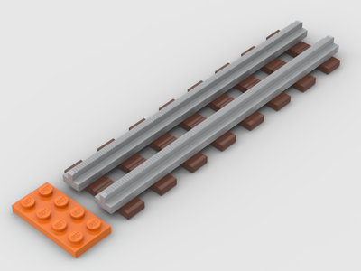

ISD Posted March 20, 2020 Posted March 20, 2020 I'm working on a minimum gauge loco (3-stud gauge). Demo rails can be seen on the image. I need a bogie for a steam engine (0-4-0). It is limited in width: only 5 studs (with valve gear). And it must be motorised. I can use only https://www.bricklink.com/v2/catalog/catalogitem.page?P=55423c01#T=A as wheels for this train. Quote
ISD Posted March 20, 2020 Posted March 20, 2020 Could someone help me to create motorized bogie for this track? It is for the steam engine, so valve gear is also needed. Loco formula would be 0-4-0 (or 0-4-2, but I will add back bogie later). Maximum width of the train is 5 studs. I can use only https://www.bricklink.com/v2/catalog/catalogitem.page?P=55423c01#T=A as wheels for this bogie. Quote
coaster Posted March 20, 2020 Posted March 20, 2020 Short of sourcing a 3rd party motor, you're probably limited to using one of these: https://www.bricklink.com/v2/catalog/catalogitem.page?P=2986 In order to keep it narrow enough, you'll probably need to attach a worm gear to the end of that motor and have it drive a small gear mounted between 2 thin Technic liftarms, though that may still be too wide. I'd have to play with it a bit in Stud.io to see what works. I'm not sure what his Eurobricks handle is, but Rob Hendrix has motorized a number of tiny locos. You can find him in the LEGO train groups on Facebook. Would love to see what you build. This sounds great. Quote
zephyr1934 Posted March 20, 2020 Posted March 20, 2020 1 hour ago, ISD said: Could someone help me to create motorized bogie for this track? It is for the steam engine, so valve gear is also needed. That's a tough one, a single stud between the rails. Here are a couple of builds that have two studs between the rails: example 1, and example 2. Bonus example 3. I've seen at least two or three others but do not have those links handy. Quote
ISD Posted March 20, 2020 Posted March 20, 2020 1 hour ago, zephyr1934 said: That's a tough one, a single stud between the rails. Here are a couple of builds that have two studs between the rails: example 1, and example 2. Bonus example 3. I've seen at least two or three others but do not have those links handy. One example: It is driven using a belt + that yellow parts. Quote
zephyr1934 Posted March 21, 2020 Posted March 21, 2020 22 hours ago, ISD said: It is driven using a belt + that yellow parts. Belt drive is iffy, you need high tension to ensure the yellow bushing will turn, but that then results in high friction between the technic axle and lift arm. I tried it with this little engine, and it probably cannot pull much more than the battery box car. I'm not saying it can't be done, just that it will be non-trivial Quote
