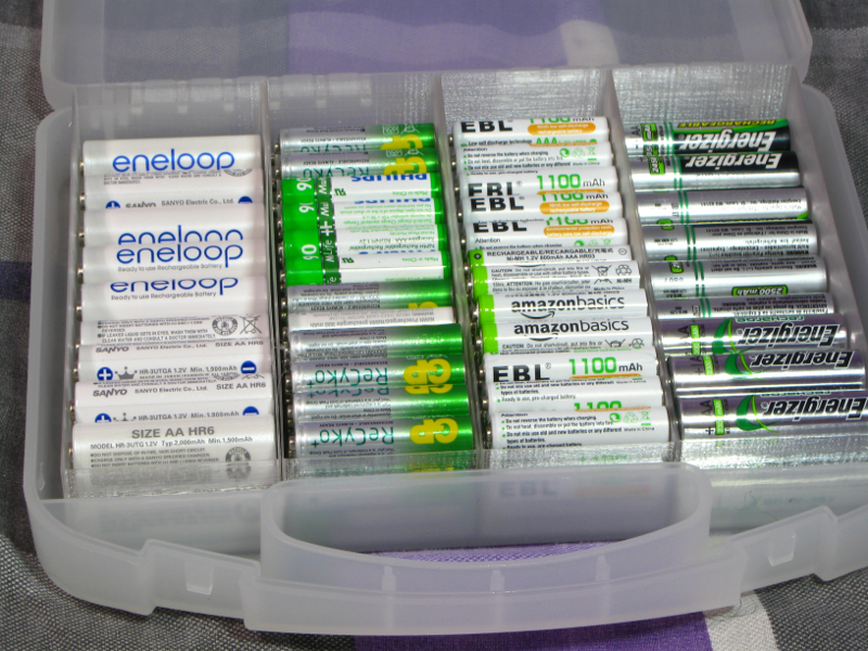

dr_spock Posted January 18, 2024 Posted January 18, 2024 NiMH rechargeable batteries. Recharge them as needed. Multiple trains as in several trains at the same time? Or two or more locomotives in the same train? Quote
Kirederf Posted January 18, 2024 Posted January 18, 2024 2 hours ago, dr_spock said: NiMH rechargeable batteries. Recharge them as needed. Multiple trains as in several trains at the same time? Or two or more locomotives in the same train? Ha OK, is that really how everyone does it? I was thinking whether there was a Lego lithium ion battery pack chargeable by USB cable i didnt know about. I honestly didnt realise its just endless replacing of batteries to keep these things going. and on the multiple trains question. Both honestly... I was thinking two or more trains at the same time, but I can also imagine that if you start adding more carriages you might want stronger motors. But I havent gone beyond 4 at the moment and it seemed to work fine so far. So not sure if people really ever need 2 locomotives (apart from design, which can be quite cool) side question: Do you use the standard delivered lego train engines (that are also used in the lego trains) to power them or do people also use lego techniq motors and customer designed powering system? Thanks for your fast response! Quote
