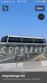

April 22, 20204 yr Author Here’s a cable propelled system that switches cables at the end of the line in Oakland California this system would be neat to build in LEGO bricks
