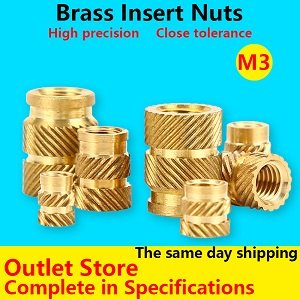

The weight challenge has occurred to me (especially those chonky CPU heatsinks). This is why I am building with LEGO Technic bricks and I am confident I can make a very sturdy construction. Just to be sure, I plan to use brass insert nuts to properly secure motherboard spacers into the 3D printed plastic.
Brass-Insert-Nuts-Injection-Hot-melt-Brass-Nut-Double-Twill-Knurled-Brass-Nut-Hot-Pressed-into.jpg.33b5e1674d818e4778610468b22f47de.jpg

Brass insert nuts are very secure. I was not able to pull them out after they set in. The surrounding PLA plastic broke first.

How do you mount those brass  insert nuts?
