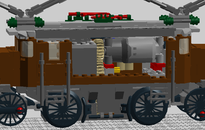

New to eurobricks, not super sure about uploading files. This is a quick idea I played with in LDD for motorising with PF. Battery box is in the same place as PU, IR receiver is placed at the back of the other end. On top of the technic 1x4s and where the PF cable would be, there are jumpers which hold an L motor sideways. The spacing is right for a 20T gear (keeping the gear ratio the same). The roof needs to be modified to fit it. I haven't built mine yet but there should be enough room to run the cables. I don't want to buy into PU and prefer my locos to be powered rather than a wagon.
Having tried a modification identical to this i found that the if the locomotive enconters any resistance then the motor lifts of the jumper plates causing the gears to skip which is why I went for this approach in the end. https://www.youtube.com/watch?v=wufXpxX4NDU&feature=youtu.be
I had a feeling that may happen as the clutch between a stud and Technic hole isn't loads...anyways great solution! Will probably use this. Did you have any issues with the IR reliever being buried inside the loco?
Not really as lon as the remote is pointed in the general area of where the ir reciver is it seems to work
