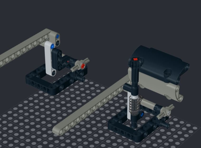

BrickMonkeyMOCs Posted June 2, 2023 Posted June 2, 2023 I'm currently rebuilding a friend's busted up Sian, and have reached the beginnings of the paddle-shifting mechanism at Step 169. I know in my own model this mechanism now tends to not fully engage the 90deg switching. Would it help to use black friction pins here in place of the frictionless grey pins? (I have a vague memory of seeing this suggestion somewhere before but couldn't find anything in this thread on it.) Or does anyone have any other easily implemented suggestions for improving the mechanism? Quote
BrickMonkeyMOCs Posted June 13, 2023 Posted June 13, 2023 I've finished rebuilding both my friend's and my own Sian models, and in both models I have removed the rubber-band mechanism added in building Steps 273-275, instead using the grey 1x3 cross-block (#32184) to lock the vertical axle (i.e. the assembly added in Step 246) in place. There is still enough give in the assembly for it to work, and I'm finding that this modification provides more positive pressure to the reverse side of the switching mechanism, resulting in smoother and more reliable gear changes. I'd be curious to know if others have tried something similar. Quote

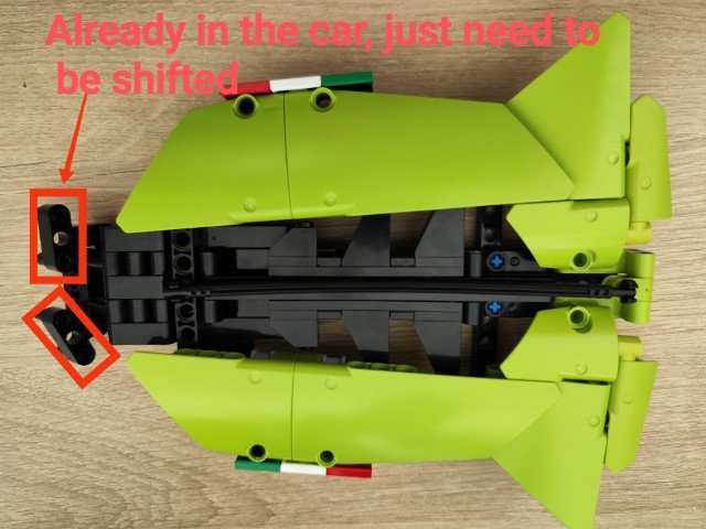

labukane Posted September 14, 2024 Posted September 14, 2024 (edited) Hi Guys, Thank you for you work. I'm so sad I arrive so late in to the party. I just got my Lambo a few weeks ago. I just applied all the mods proviede by @jb70 and @astyanax. There is one thing that doesn't work for me and one that is still missing for me. The worm gear for the rear spoiler doens't realy work. The rear spoiler only lifts about 1 cm and I think it would normaly lift about the double. I really would like to hinge the engine cover. I managed to find something easy to had and that respect the height, but I don't find it very stable or elegant and the engine cover doesn't hold very well in place. Would you help me improve it please ? Or maybe there is already a good solution ? I don't know how to put more than one picture at the time, it is already to heavy. please let me know how to do so you can see other and better angles Edited September 14, 2024 by labukane Quote
labukane Posted September 15, 2024 Posted September 15, 2024 Hi again, I know my picture doesn't show much. But I can only post one. I can show more using Cjoint if someone would be kind enough to answer me Quote
Jurss Posted September 15, 2024 Posted September 15, 2024 Please read the forum rules, then You will know, why You can post "only one" picture. Quote
