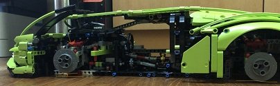

4 hours ago, stevenhalim said:
You remove the white 4L lightsaber bar that is really the only way to make the car has positive rake, without that both front and rear suspensions are "equal" = flat.
Let's find a solution to make the positive rake back?
I look at Sian's side view several times, the car do feel that it slightly pointed downwards (positive rake)
I already suggested to add a 1L beam to the 2L axle sticking inside the top suspension arm. That would have a similar and "sustainable" effect. Can you test and compare it to the 4L lightsaber solution?
I just tested it, the positive rake angle increased by too much, making front suspension becomes Bugatti-ish..., I think I prefer to sacrifice the 4L lightsaber... it is "official solution" :O.

On 6/23/2020 at 1:59 AM, allanp said:
Many people might not have this problem, but we are so close to the edge of being barely functional due to these over-complex designs that any barely noticeable manufacturing flaw can cause this to happen. I noticed when a lot of people were having problems with the 42009 outriggers barely moving that some axles straight out of the box were ever so slightly bent. So I built an axle tester by placing a bunch of 1x2 Technic bricks next to each other on a 2x8 brick. Half the axles fell straight through but many of then fell slowly and many didn't fall through at all. After building 42009 using my tester on every axle the outriggers worked as well as I've seen in any video (not great, but they worked). Tiny imperfections like this caused some people to have the issue, and some people not to.
Source.
