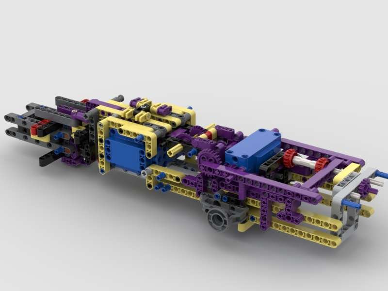

Hi,
After about 20 years of not building a Lego set, I started working on it again. After the daughters had put some Lego Friends sets together I had to do this.
Recently I built this Volvo A60H and I wouldn't be me if I had to change anything. I don't like the use of the Lego Control+ app. That is why I use theeBricklink2 app to control the Volvo.
I didn't like the idea of using the gearbox to control the tipper. That's why I built in an extra L-engine to drive it directly.
In attachment some renders of my conversion/adjustments. The necessary parts are on their way and as soon as they are there the final modification will be done. I also did the Efferman upgrade of the articulation/steering.
In Studio I did all the extra pieces that were needed in purple to see a good difference between the original pieces of the set.

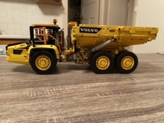

On 12/10/2020 at 9:06 PM, Ngoc Nguyen said:
130740511_1327177900978019_3473463211184
looking at this picture, they needed to provide black rims, so that only those inserts (thread gears) are yellow.
I did try black rims with yellow inserts. The model actually looked worse.

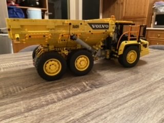

On 1/3/2021 at 1:49 PM, curakar said:
Has anybody made a modification of the dump bed ? I think the original one is to large
Done!
Reduced by 2 studs in every direction.
