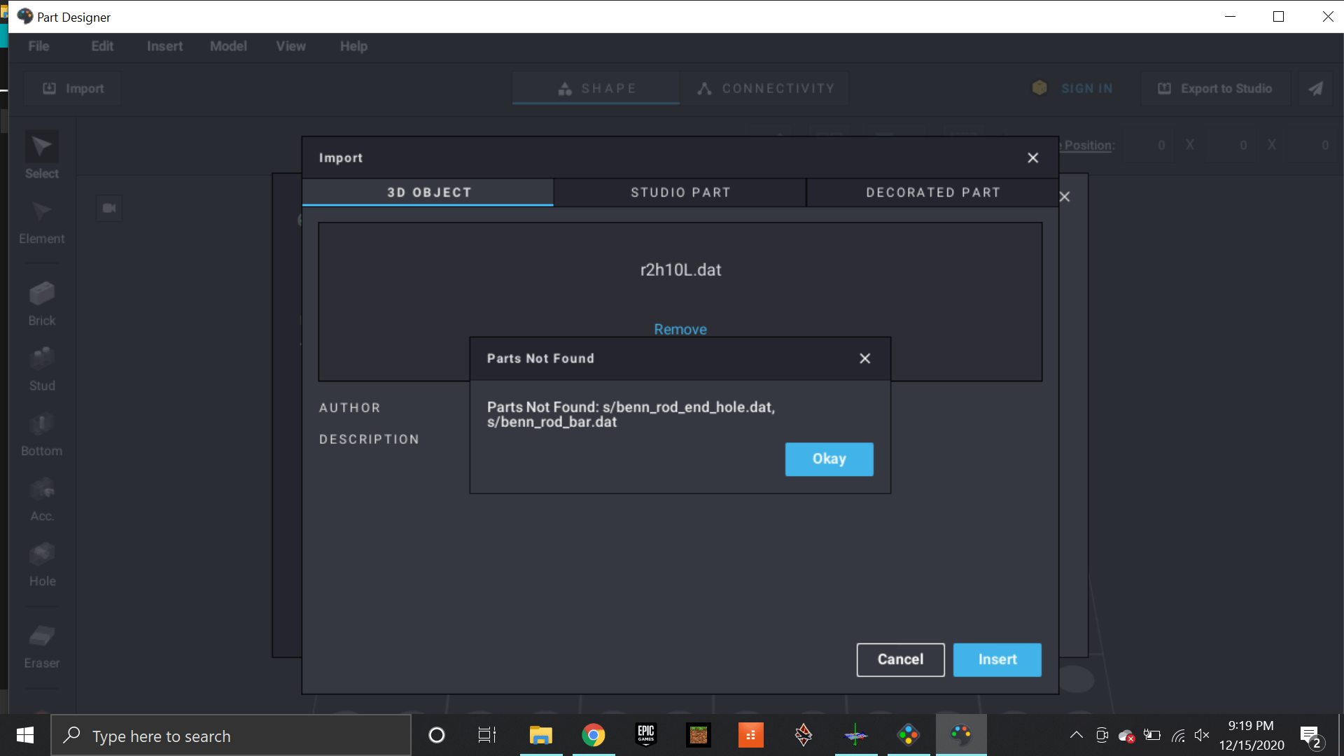

Christians Trains Posted December 16, 2020 Posted December 16, 2020 (edited) On 10/4/2020 at 9:42 AM, zephyr1934 said: You click on each one and then in your browser select "save". They are text files (but make sure you use the .dat extension so that LDraw will recognize them). I could bundle them up into a zip file if you continue having problems (but that would have to be in a day or two, I need to get running right now) this happens when I try to load any rods. I have the s\ pieces downloaded as .dat files and I can bring them up individually in studio 2.0 but when I try for a whole rod it does this. Edited December 16, 2020 by Christians Trains Quote
Barduck Posted December 16, 2020 Posted December 16, 2020 (edited) did you add those in the proper LDRaw folder? Most commonly it should be in c://users/public/public documents/LDRaw/Unofficial/Parts/ for the actual rod and ...(same)/s/ for the files that tell it how it looks (like benn-rod-end-hole.dat) Edited December 20, 2020 by Barduck typo Quote
Christians Trains Posted December 18, 2020 Posted December 18, 2020 (edited) On 12/16/2020 at 5:42 AM, Barduck said: did you add those in the proper LDRaw folder? Most commonly it should be in c://users/oublic/public documents/LDRaw/Unofficial/Parts/ for the actual rod and ...(same)/s/ for the files that tell it how it looks (like benn-rod-end-hole.dat) thanks! Edited December 18, 2020 by Christians Trains Quote
petew889 Posted May 29, 2022 Posted May 29, 2022 How do i change that? I have the same problem On 12/16/2020 at 5:42 AM, Barduck said: did you add those in the proper LDRaw folder? Most commonly it should be in c://users/public/public documents/LDRaw/Unofficial/Parts/ for the actual rod and ...(same)/s/ for the files that tell it how it looks (like benn-rod-end-hole.dat) how can I adjust that? I have the same problem with uploading the rods h Quote
