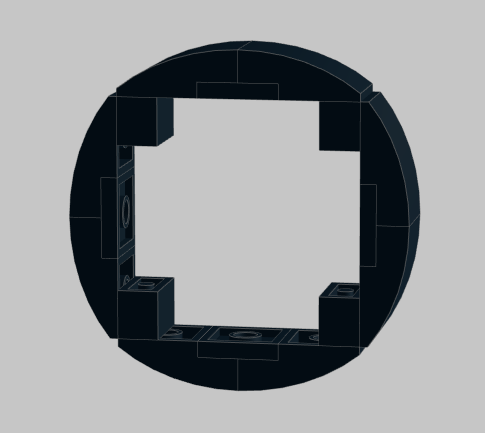

I hope you don't  mind if I mention two issues that may be improved:
The boiler diameter is too large in my opinion. A little more than 8 studs should suffice.
And of course @monai is right with regard to the wheels. The prototype's 1000 mm diameter translates to 45 mm for the model, which means XXL wheels for the model (43.2 mm).
Be careful with the drivetrain layout! To move such a big locomotive, the gears and the motors need to be connected very, very firmly, or it'll take your drivetrain apart.
Will there be a black version, too? The prototype never ran in gray, that's just for builder's photos.
Edit: Forget what I wrote about the boiler diameter. I just looked it up in my library: The prototype has ~1600 mm outer diameter, which would be pretty exactly 9 studs for the model.

Regarding the wheels, the model currently uses XL sized drivers. I agree one size up will better suite the scale. Are Ldraw files available from anyone for these parts? I am using Bricklink Studio to make these models and images on my flickr. Thanks also for the complements regarding my recent diorama. Somehow, I am addicted to making designs and images with this software. The renders that come out of the software are quite good, but I always sharpen them up and add a little impurities to be a little artistic. It is satisfying to keep people guessing whether or not what they are seeing is photographic.
The accuracy of the boiler size is something I might contest. Via the schematic posted above, I estimated the height of the smokebox, excluding what I'm guessing is a water heater, is about 1.7 meters. Calculating for scale, this is about 24 plates. The result is about 25 plates, which is a little large, but satisfyingly rounded via compounding different curved slope elements. The cross section @Tenderlok provides is 21 plates across, which could be boosted by a plate in all directions for a 23 plate diameter, though I think the resulting kinks in each quadrant would be an aesthetic casualty of this solution.
(Other considerations regarding 1:22 scaling can be seen on this spreadsheet)
Perhaps now that I have added pipe greeblies to the boiler, the visual mass of the surface is divided enough to look... less massive?
