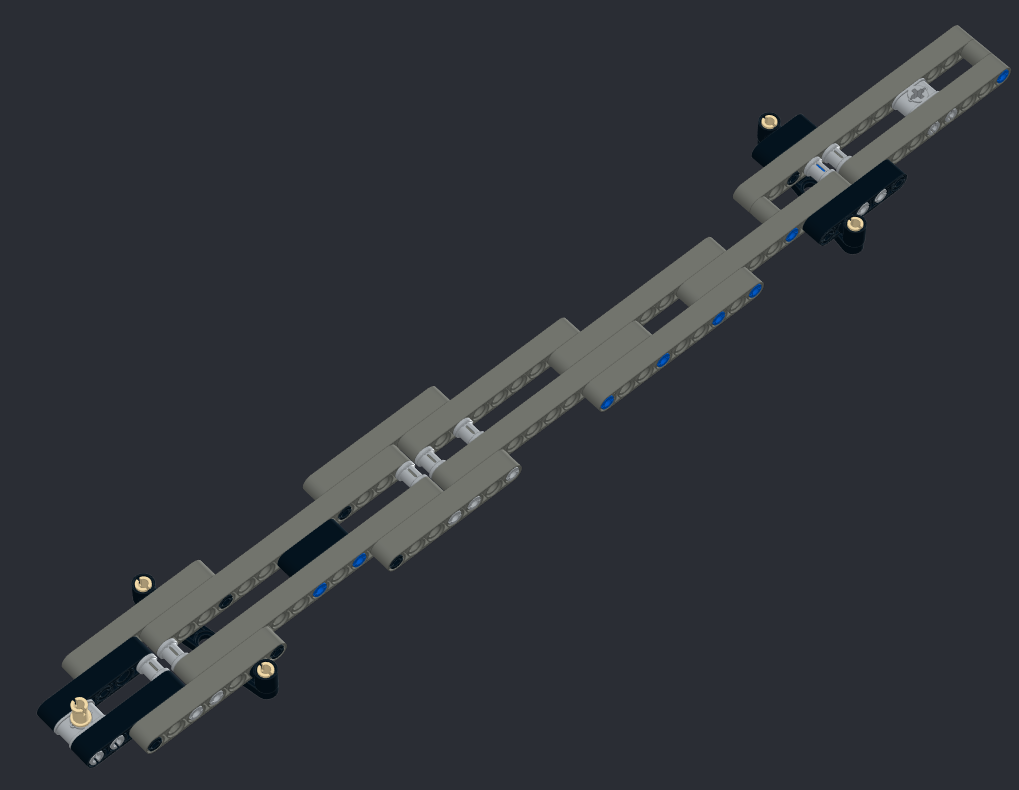

Dawid_Szmandra Posted November 26, 2020 Posted November 26, 2020 Hi, I'd like to present my latest project, the Liebherr LTM 1250-5.1. Some people will probably be bored because it is almost the same crane again, but maybe it will interest someone. LEGO Liebherr LTM 1250-5.1 by Dawid Szmandra, on Flickr The project began with a new steering control concept that uses two servos to steer a long beam along the vehicle. The turn of each axle is connected to it and by moving it in parallel, all the wheels turn by the same angle, moving the beam to the left on front and to the right at the rear, the wheels will turn respectively. This allows the individual axles to turn by different angles with normal steering and the same angle with crab steering. it is also very easy to use, because we only have two servos and by changing the polarity of one of them (with the button on the SBrick profile) we change the steering mode between crab/normal. By controlling one servo, you can also turn only the front axles, or only the rear axles (in real cranes there are also such steering modes). I don't know if I have described it clearly, but I hope so. ? The effect is best seen in the video. Steering + drive is made as a separate module for easier build and can be seen here: LTM 1250-5.1 by Dawid Szmandra, on Flickr The rest of the model is rather standard. 7 motors, 4597 parts, 3 section boom with a third section moved by a string. I tried to make the model as simple to build as possible, therefore it is very modular, with a limited number of illegal techniques and weak connections. It should be simpler and nicer to build than the previous LTM 1070. LEGO Liebherr LTM 1250-5.1 by Dawid Szmandra, on Flickr Some sample pages from the manual: Flickr: https://flic.kr/s/aHsmSgNcHkInstructions: https://szmandracranes.e-junkie.com/Instruction om rebrickable: https://rebrickable.com/mocs/MOC-57421/Dawid_Szmandra/liebherr-ltm-1250-51 Quote

Jeroen Ottens Posted November 26, 2020 Posted November 26, 2020 You have a very high standard! I have been thinking about a similar setup for the steeringmodes, but I thought the long beam would not be stiff enough to give proper steeringangles for all axles... Did you do something special to reinforce it? For the rest it is a masterpiece Quote
Dawid_Szmandra Posted November 26, 2020 Author Posted November 26, 2020 (edited) Here is the beam. Nothing special to reinforce it, but it is quite strong for bending . Edited November 26, 2020 by Dawid_Szmandra Quote

steph77 Posted November 26, 2020 Posted November 26, 2020 (edited) How do you want us to be bored facing such creation???? I have some question sir : - Does the direction setup be based (basically) on two independant servos. Each of them connected to respectively 2 and 3 axles with different lock angle? I guess it cannot be as simple due to fact that crab steering need the same angle for each axle when normal steering mode needs différents angle for each. How do you solved that? - The linear actuator is a XL one? true? However, the maximum raising angle doesn't seems to be that important. Wheight issue? GREAT model. You surely do not have to hesitate in case of recidive :) Edited November 26, 2020 by steph77 Quote
Dawid_Szmandra Posted November 26, 2020 Author Posted November 26, 2020 7 minutes ago, steph77 said: Each of them connected to respectively 2 and 3 axles with different lock angle? No, front servo is connected to front end of the beam, rear servo is connected to rear end of the beam. Axles are connected to the beam. The beam moves sideways (parallel or X-shaped) 12 minutes ago, steph77 said: The linear actuator is a XL one? true? However, the maximum raising angle doesn't seems to be that important. Wheight issue? Yes, it is long actuator, but it is still much too short, so the boom raising angle is too low. Quote
pdw Posted November 26, 2020 Posted November 26, 2020 Very nice, and a very elegant solution to the steering. I assume the beam is only pinned in one place, and that all the other connections slide in the central channel of the beam? I'm working on a model with mixable crab/normal steering, but I only have two axles to worry about! Quote

Dawid_Szmandra Posted November 28, 2020 Author Posted November 28, 2020 On 11/26/2020 at 5:07 PM, pdw said: I assume the beam is only pinned in one place, and that all the other connections slide in the central channel of the beam? Exactly this On 11/26/2020 at 5:53 PM, Erik Leppen said: Now this is something! Thanks, after my dark age (~2007) I spent a lot of hours studying your brickshelf gallery, you were one of my authorities back then, so it's nice to hear that! On 11/26/2020 at 6:27 PM, Brickend said: I guess limiting the driven axles keeps the drivetrain losses to a minimum? Yes, the drivetrain is simple and effective, And 1 driven axle seems to be ok for flat surfaces. On 11/26/2020 at 6:27 PM, Brickend said: Was it difficult getting permission from Liebherr to reproduce their logo for sale? Hmm, I haven't even asked them yet. So stickers are currently illegal, but I'll ask them. Quote
