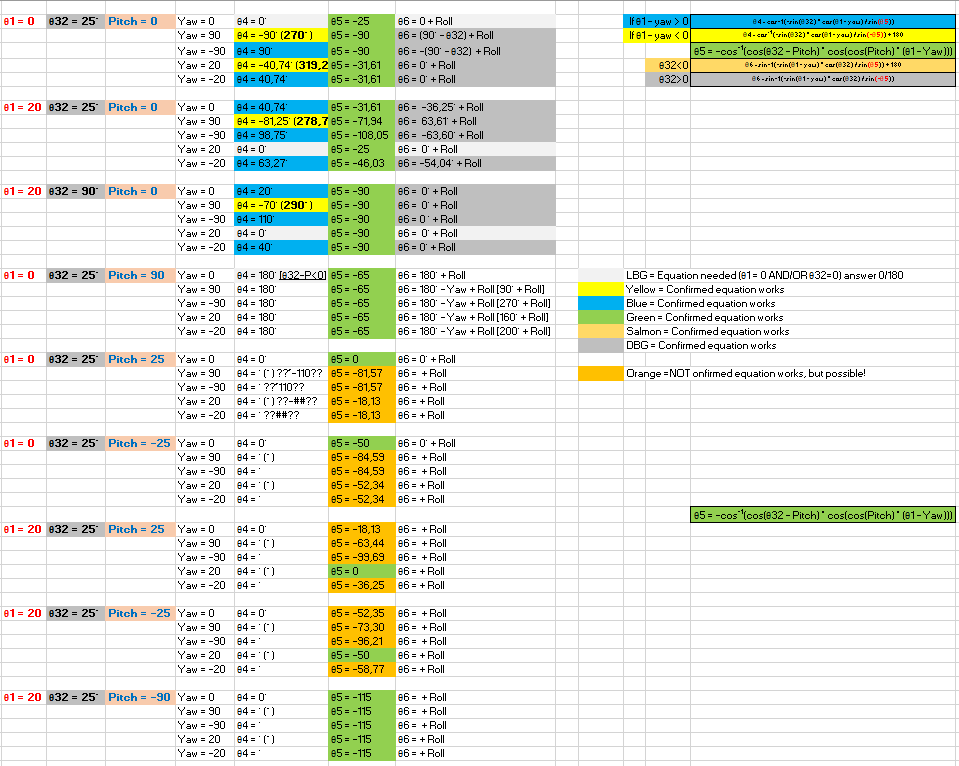

Mr Jos Posted January 29, 2021 Author Posted January 29, 2021 (edited) I'm pretty sure I just found the answer for θ5. For every case using any [Roll, Pitch, Yaw] matching any angles [θ1, θ32] that I tried it seems a logical result for me. After θ1, θ2, θ3 that are easy, θ5 is actually just a very short but easy calculation with no need of an equation, but if you don't have any documentation like me it's tough. Tomorrow I start searching θ4 and maybe θ6. If I do find it I will clean up my program a bit and show to those who are interested, or just give some hints how to do it. Here is what I got so far, color code is in the screenshot. Edit: θ4 and θ5 seem to be working good now with pitch in a few tests (but without yaw/roll mixed) as my θ6 is still not good for pitch, I get Math Domain error whilst I did not expect it. Edited January 30, 2021 by Mr Jos θ4 and θ5 found for pitch Quote
Mr Jos Posted January 30, 2021 Author Posted January 30, 2021 (edited) Quick update: It's alive! Roll/pitch/yaw of end-effector is fully functioning. I can make it take any stance, and fluidly transition to the next stance whilst moving to new X/Y/Z coordinates. Only thing is that it sometimes does a 360° on the θ6 whilst unwanted, need to look how I can solve that, but the biggest part is finished. Thought it would never be possible with Micropython. I also need to change the path finding as it takes XYZnew - XYZold and moves 6mm at a time to the largest of those 3 distances. But now that I can roll/pitch/yaw around 1 XYZ point I need to look into moving certain ° at a time if the XYZ distance is to small (or 0). Once that all is finished I will take another video and those who want to make their own 6DoF move with IK can try to see in my messy program how I did it. To do: - Remove unwanted 360° turns on θ1, θ4 and θ6. - Change pathfinding for short distances, but high roll/pitch/yaw change. - Cleanup program. - Make a video EDIT: 360° Unwanted solved! Edited January 30, 2021 by Mr Jos Quote
