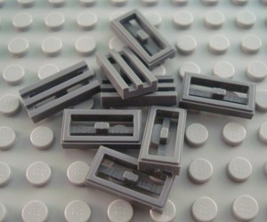

Kuvahaun tulos: lego grille plate
I think these would make it look better with a black plate underneath.. Since you have an odd number of beams in the grille, you'd need to set the plates off center with half pins so it has a half stud hole between the edges.
And this half stud whole between edges of plates and beams bothers me. Apart from the fact I do not know how to do this when I have only one stud of width/depth :P
