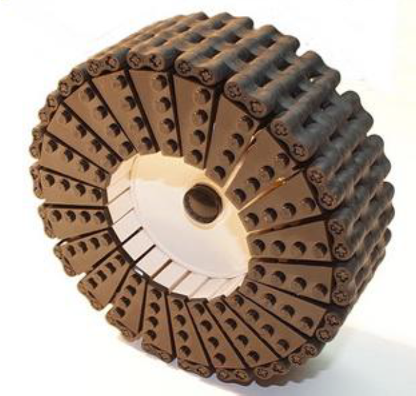

MP LEGO Technic creations Posted March 26, 2021 Author Posted March 26, 2021 10 hours ago, trekman said: As you will most likely be driving the large gear racks at the rear of the machine, your loading on the motors might not be as bad as you fear. They will have a natural reduction at the circumference, compared to driving a gear which is rotated at the centre. However if you try to build a centre into those wheels, then it will be a different challenge. I admire you for doing it. My bravery is normally limited to the parts which i have. My intention was to power the central axle, but I'm not very satisfied with this wheel centre. Quote
Milan Posted March 26, 2021 Posted March 26, 2021 4 hours ago, MP LEGO Technic creations said: My intention was to power the central axle, but I'm not very satisfied with this wheel centre. I would strongly suggest to power the outer ring piece, as Trekman suggested. Free reduction and smooth power delivery. Powering the central axle will twist it, and the vehicle's movement will be jerky. Quote
Void_S Posted March 26, 2021 Posted March 26, 2021 (edited) 1 hour ago, Milan said: I would strongly suggest to power the outer ring piece, as Trekman suggested. Free reduction and smooth power delivery. Powering the central axle will twist it, and the vehicle's movement will be jerky. Plus to that, if the inner part rotates (powered) when outer still stopped, the tension force will easily disassemble the "spikes" made of red axles and yellow #1 connector. I would use the liftarms (solid pinhole-to-pinhole structure), which can handle the tension forces. Besides that, I wouldn't loose in mind the rule of squares and cubes - making the model x2 bigger in all dimensions, you will get it up to x8 heavier. It makes a huge sense for plastic parts! Edited March 26, 2021 by Void_S Quote
MP LEGO Technic creations Posted March 26, 2021 Author Posted March 26, 2021 1 hour ago, Milan said: I would strongly suggest to power the outer ring piece, as Trekman suggested. Free reduction and smooth power delivery. Thank you for suggestion. This will probably be the only solution that could move a vehicle like this smoothly. 1 hour ago, Milan said: Powering the central axle will twist it, and the vehicle's movement will be jerky. That's what I was afraid of. Quote
MinusAndy Posted March 26, 2021 Posted March 26, 2021 You could use a pair of 57585 connectors in opposition on a central axle to give you a stronger hub connection, then drive it through the rim? Quote
MP LEGO Technic creations Posted March 26, 2021 Author Posted March 26, 2021 28 minutes ago, MinusAndy said: You could use a pair of 57585 connectors in opposition on a central axle to give you a stronger hub connection, then drive it through the rim? I haven't decided the way to build the wheel yet. But I'll remember your suggestion and test it on the wheel prototype Quote
Milan Posted March 26, 2021 Posted March 26, 2021 I would also suggest to make a custom hub to hold the wheel/sprocket firmly. For this 142mm wheel, i made, for example, a heavy duty hub, made out of two turntable pieces (one studless, one studful), to withstand the forces. It also served as hub reduction, as it was driven by 2 of the 8t gears. Quote
MP LEGO Technic creations Posted March 26, 2021 Author Posted March 26, 2021 2 minutes ago, Milan said: I would also suggest to make a custom hub to hold the wheel/sprocket firmly. For this 142mm wheel, i made, for example, a heavy duty hub, made out of two turntable pieces (one studless, one studful), to withstand the forces. It also served as hub reduction, as it was driven by 2 of the 8t gears. Looks interesting! Quote
Milan Posted March 26, 2021 Posted March 26, 2021 You can attach the big turntable to the Ferris Wheel and get a really strong connection to the chassis. Quote
