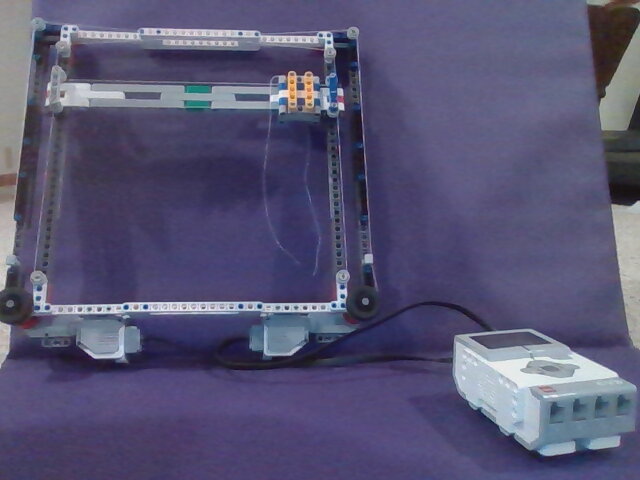

ElectricTurtle Posted January 26, 2024 Posted January 26, 2024 Thanks! I'm working on a plotter using CoreXY with nylon thread, I got all the math worked out but now I need to put a pen on it. Quote
ord Posted January 27, 2024 Author Posted January 27, 2024 Nice! I originally planned to build a CoreXY style plotter but figured out other ways to mount the motors remotely, so went with that. Hopefully we can see yours in action soon. Quote
