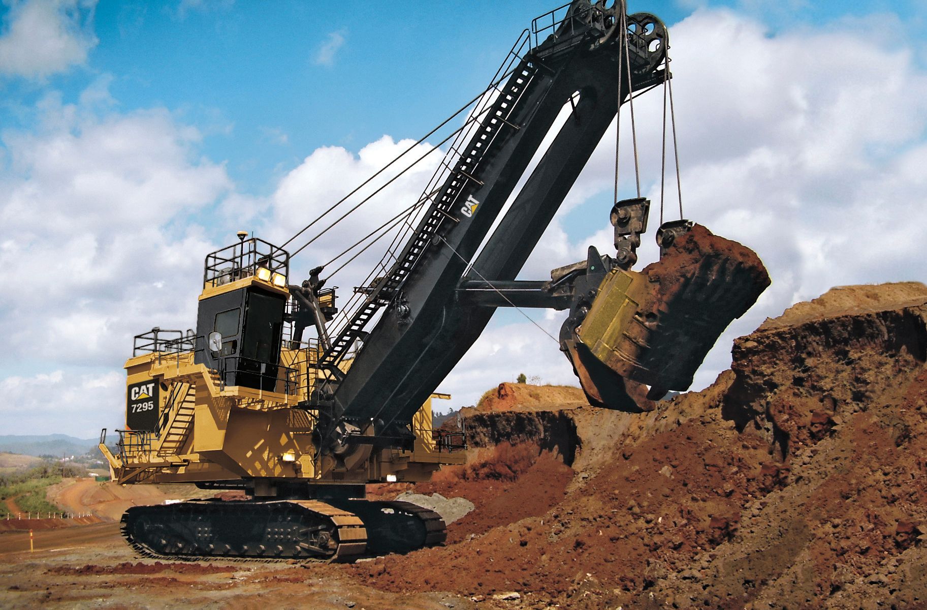

It is a rope shovel excavator based on Cat 7295 HD. I have chosen this one as it is big enough for this scale (~1:40) while not too big like its bigger brothers (7495). Here is a pcture of the real machine:
C807332?$cc-g$&fmt=pjpeg
the problem is that the internet is full of pictures/models and other source material about the "biggest" 7495, but the smaller machines are without much attention. Therefor I had to work with several pictures only, but in the end it was enough. When I started the build I thought that it might be a "true" scale model with exterior build from system parts. You can see its remains on the boom. This was also the reason of the delay, it would mean buying a lot of parts that I lacked and the financial aspect put it on hold. In the end I decided to cover it in regular manner with additional details from system parts here and there.
