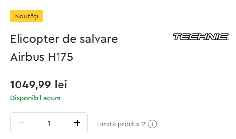

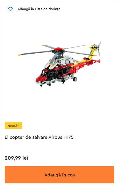

Danke Posted August 12, 2022 Posted August 12, 2022 Unsure how revelant to the topic it is but there was a pricing error (up until yesterday) on the romanian lego shop listing this set at 210 ron (or 42 euro). Managed to grab one and it arrived today, unsealed and in bad shape but seems complete. Quote
