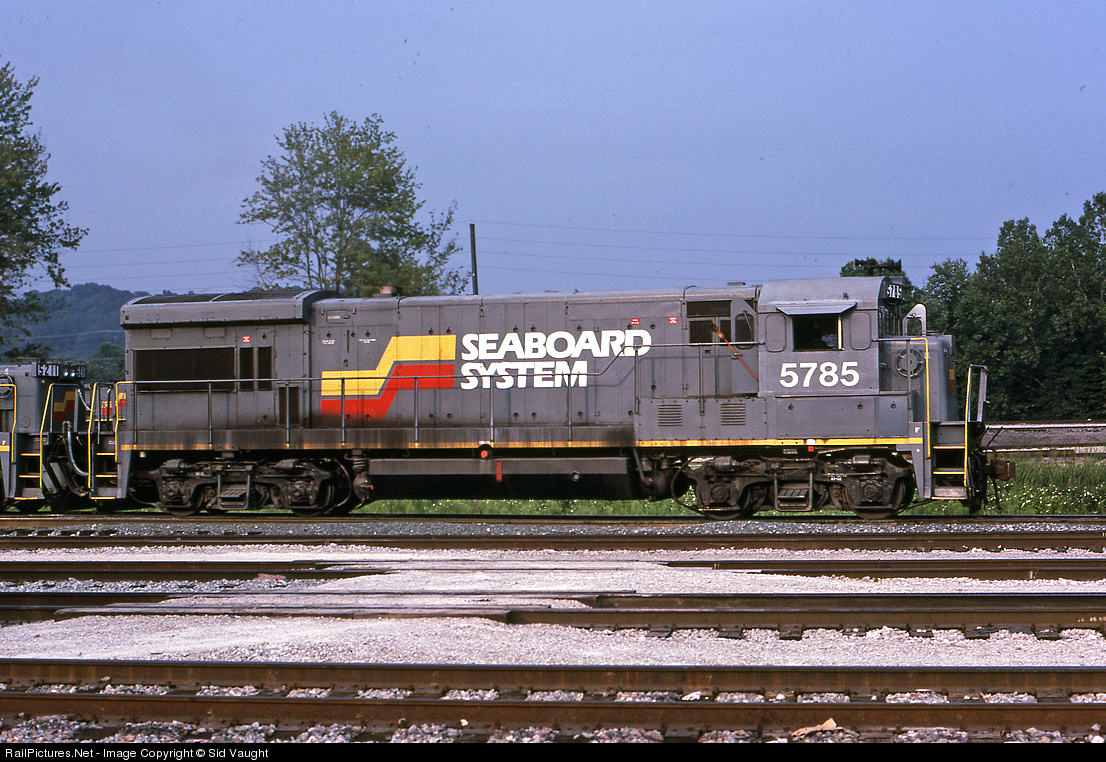

I haven't built a new diesel MOC in a little bit, so I decided to take a crack at a new challenge. This time, I decided to try and do a GE U36B. These were part of General Electric's 'Universal' Series, with 3600 HP and a B-B wheel arrangement, hence the name. 125 were produced between 1969 and 1974, with most of them going to Auto-Train and Seaboard Coast Line (Later CSX). As far as I can tell, most of these units were scrapped with only a few remaining examples today.
CSX%205772%20%205-21-1988%20Waycross,%20
