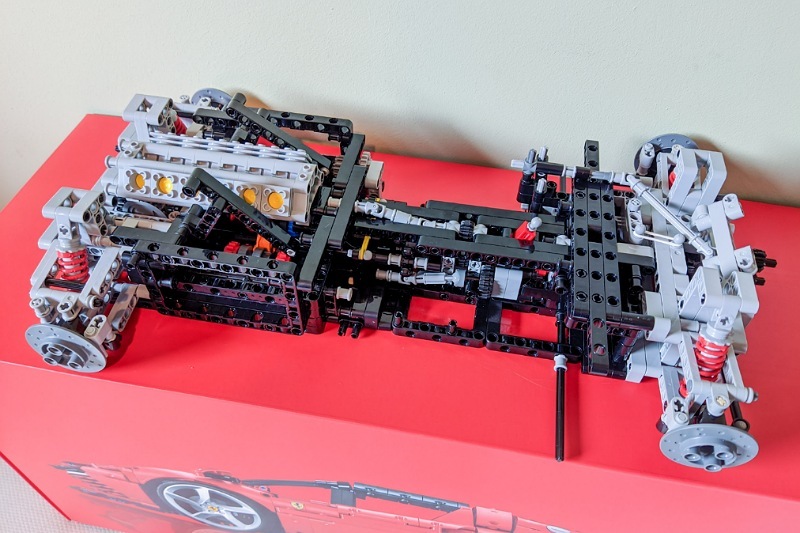

After Pimping up the Gearbox I am proudly to present the next step in the "Pimp up my Ferrari" project:
  • Slightly modified front axle with Ackermann Steering and better turning radius of the car and gear rack limiters
  • HOG Steering
  • HOG Gear Indicator and Gear Shifter

HOG controls are integrated seamless both easy-to-use and nearly invisible into the original cockpit design.
Some close-ups to the internals:

If you are interested in more details, have a closer look to the digital models:
Building instructions and part list are still Work in Progress

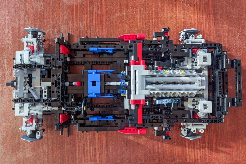

With Pimp up my Ferrari v0.4 I made some more improvements:
  • PDF building instructions are now available until end of Box 1. That is about 1/3 of the complete build, but containing all the technical mods and the chassis is ready to drive in that stage.
  • Modified car bottom with some nice open windows, that give a clear look to all relevant technic features inside. Some color changes as well for a clean look.
  • Optimized geartrain: The first gear mesh between differential and gearbox has been reduced from 24/8 to 20/12. Instead the last gear mesh between DNR box and the engine has been speeded up from 20/12 to 24/8. So the final speed of the engine keeps the same, but the gearbox itself runs slower and produces less friction. Some joints between gearbox and DNR needed to be modified as well to allow free run of the new 24t gear behind the DNR box. The knob gears of the gearbox have been swapped, so they do not collide with the U-Joints of the geartrain.
  • The driver's steering wheel is geared down by 8/24 instead of 12/20 before.
Some pictures with details:

If you are interested in more details, have a closer look to the PDF or the digital model:
Building instructions and part list are still Work in Progress. I am looking forward to include more MODs...

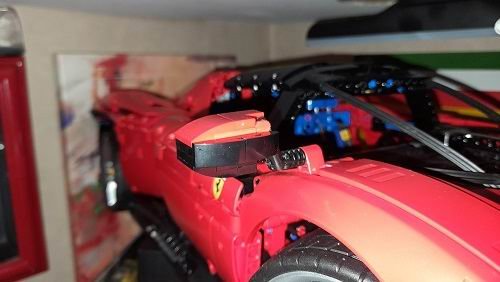

I have pimped my Sp3 with a range of mods , described at this forum. The mirrors are based upon a mod on de mirrors of the lamborghini Sian set. The  engine is modifies to my own view of the real engine with a different enginecover with altered connection to the airducts.
Pictures can't be published (max 0,01 MB upload which is absurd)

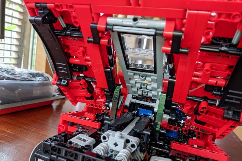

With Pimp up my Ferrari v0.7 I made a few more improvements:
  • Spring-loaded Doors
    • By adding a technic shock absorber the wing doors are now better fixed to keep in either closed or open state. This allows to remove several friction pins in the door mechanism and replace them by non-friction pins or axles. The complete door mechanism works much smoother, now.
    • You can open the door either manually or by pushing the yellow levers underneath the hood.
    • By adding a simple grey 1x1 round tile on top of a technic 1/2 pin the door is now fixed in closed state and allows the moving-to-the-side-part of the door to come back into closed position without colliding with chassis.
  • Foldable Roof
    • Many Thanx to @zonoskar for this cool MOD.
    • On 8/2/2022 at 4:40 PM, zonoskar said:
      Hi, trying to keep the pimp-my-Ferrari thread alive. I made a modification to the set so you can fold the roof and put it in the frunk. There's enough space there for it, once folded. It only uses a few extra parts: Foldable roof for 42143 on Rebrickable
    • I just made minimal changes like adding a technic axle in the middle, adding some 1/2 pins to keep the roof stable in unfolded position and modified the holders on top of the windscreen to keep in black.
Some pictures with more details:
