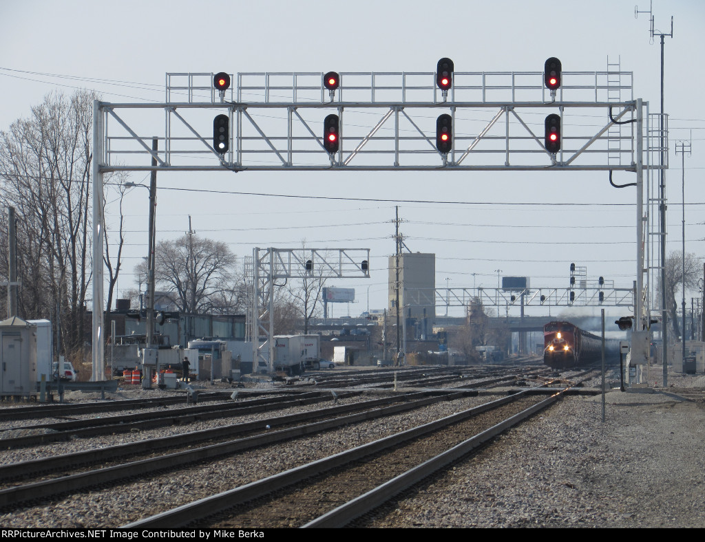

My one criticism is that it looks very, very European. I realize that we have some signals like that in NA, but the majority are still constructed as cantilevers/signal bridges over the tracks. I think you'd want to offer that as an option if you wanted to sell to NA customers.
Basically I didn't created this setup to sell it - it is for my own entertainment and one more play experience addition to our LUG when we have public, joint display. Andyes, it is European, since I am modelling XXI. century Hungarian railroad. We have also some signal masts where there are three or more tracks next to each other, or if for any reason traditional signal poles doesn't fit next to the track, but these masts are rare and using them on my layout wouldn't be authentic.
