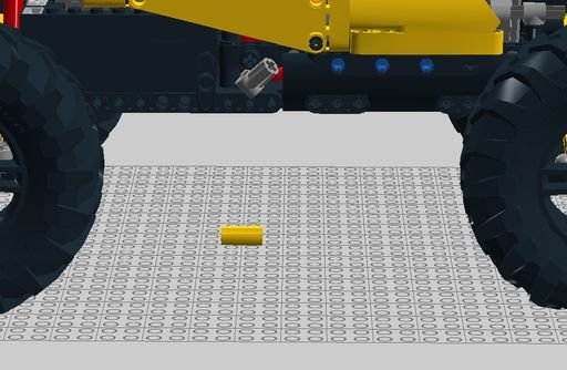

pankov Posted February 14, 2023 Posted February 14, 2023 On 1/27/2023 at 1:59 PM, Zerobricks said: LDD file link: https://bricksafe.com/files/Zblj/universal-4x4/Universal 4x4.lxf Hi, First let me thank you for the the great work - this looks amazing and I'll definitely do my best to build and try it. Since this will be my first build based on LDD files ... actually this is the very reason I have even installed LDD (v4.3.11 + the latest parts update) ... please bear with my simpleton questions. And here come the first two: 1. What am I doing wrong in order to get an error message stating that there is one brick that's not placed correctly and was removed from the model when I open the .lxf file... and how can I see which is this brick? 2. Why is there a single yellow piece (an axle connector) at the bottom of the modeling plane (not connected to anything)? Could it be the problematic brick from the error above? And if that's the case then where it's supposed to be placed? Quote
Zerobricks Posted February 14, 2023 Author Posted February 14, 2023 The axle joiner goes inside the ball joint. Regarding missplaced bricks, try opening the file with collisions disabled. More info here: https://www.eurobricks.com/forum/index.php?/forums/topic/151152-ldd-developer-mode/ Quote
