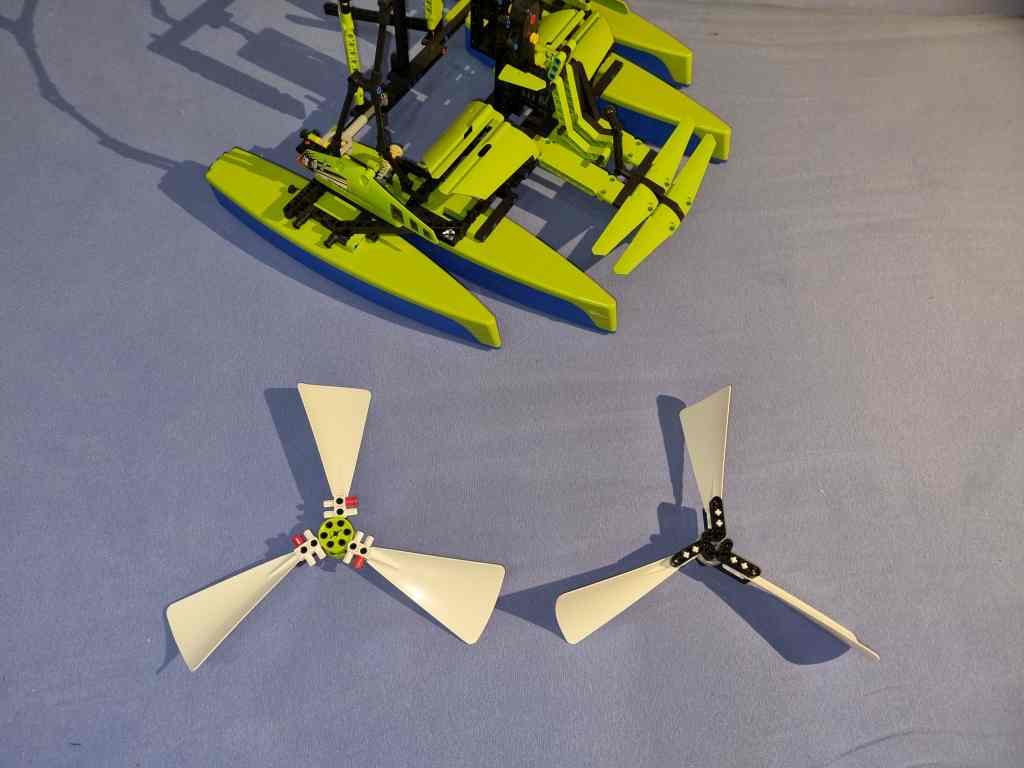

aFrInaTi0n Posted December 7, 2022 Posted December 7, 2022 (edited) More attack surface of the wings should move more air when turned by 90° as shown in the picture - they will have higher resistance though. But I am also not sure if their even wingform will lead the air into the correct direction. Couldn't test for myself, waiting for some of those expensive things to be delivered to mine... :D Edited December 7, 2022 by aFrInaTi0n Quote
Jumhansen Posted December 8, 2022 Author Posted December 8, 2022 @aFrInaTi0nCool idea ! I never thought about turning the propellerblades by 90°. I will try this. That part is really expensive and rare. Jumhansen Quote
aFrInaTi0n Posted December 8, 2022 Posted December 8, 2022 (edited) 1 hour ago, Jumhansen said: @aFrInaTi0nCool idea ! I never thought about turning the propellerblades by 90°. I will try this. That part is really expensive and rare. Jumhansen Recently found out that CaDA luckily offers them too for less money too. The originals will succeed the value of gold soon I guess... 😪 Keep us updated, will also work on one tech study with those propellers.. 😅 Edited December 8, 2022 by aFrInaTi0n Quote

Jumhansen Posted December 8, 2022 Author Posted December 8, 2022 @aFrInaTi0n I hope this propellerblades will reach the value of gold. Otherwise the panel nr. 5 or nr. 6 works also very nice. I´ve built a small vehicle with thoose panels, just for a proof of concept. Thread is here in this forum. Just build something with this curved panels or the bigger one´s. I´am very excited what you will show us ! UPDATE: The propeller on the left hand side is the original one, as shown in the video. The propeller on the right hand side is the one, turned 90°, as you mentioned. I will try these two setups Jumhansen Quote

pow Posted December 8, 2022 Posted December 8, 2022 as we're in finetuning mode.... Is it perhaps a good idea to move the rotor blades outwards by one stud? So that there is a larger hypothetical total area over the entire rotor? It is easily possible with the current hub design. Quote
aFrInaTi0n Posted December 8, 2022 Posted December 8, 2022 8 minutes ago, pow said: as we're in finetuning mode.... Is it perhaps a good idea to move the rotor blades outwards by one stud? So that there is a larger hypothetical total area over the entire rotor? It is easily possible with the current hub design. In theory yes, but keep in mind that the outer end will travel more distance and gets faster therefore.. Quote
pow Posted December 8, 2022 Posted December 8, 2022 (edited) 28 minutes ago, aFrInaTi0n said: In theory yes, but keep in mind that the outer end will travel more distance and gets faster therefore.. ...which would make the build even faster or brakes the blades ... and if @Jumhansen also puts two hulls in a row forming a real catamaran this thing will become ridiculously fast and less jumpy on waves (length runs) or just a nightmare to drive Edited December 8, 2022 by pow Quote
aFrInaTi0n Posted December 10, 2022 Posted December 10, 2022 (edited) The CaDa parts arrived... 15 pieces for ~11€.. So testing failures won't result in direct bankruptcy 😅 Edit: Omfg the blades arent pushing any air outwards of their diameter... even with a MK reciever it creates a huge amount of airflow.. xD Edit2: Oh boy, in the fast output it easily leaches the battery empty with a steady current of 2 amps 🤯 at 100% - with the slower output it will go down to ~1.5 amps drain - still plenty, but I guess as its constantly working against the medium, this is expected :D Edited December 10, 2022 by aFrInaTi0n Quote

aFrInaTi0n Posted December 11, 2022 Posted December 11, 2022 (edited) sheeeeeeeeeeeesh, expert tools :D I think the weight of the construction will be the critical thing -> the longer the axle, the greater the axial forces (increased lever due to greate distance to the axlehole where it spins..). Possible solution: Aluminium axles (but those are also prone to bend under higher loads or in the long run) Also with the Voltage of the Buwizz3 instantly going down rapidly with this 2A constant load at the fast buggy output, it may not be feasible to mount even more blades (and therefore increase load even further because of more air-resistance). I think the limit for one Buwizz will be 4 blades with the wide side shoveling air at the lower output (~1.5A drain, Buwizz barely able to deliver, but Voltage also may drop fast.) + due to the motors having constant load, they easily got warm (even with air-cooling :P). Could you do the tests with both the blade configurations + with both of the buggies outputs? (also maybe having a look at the Voltage & Current @Buwizz App?). But don't feel rushed & if its too much tests also fine if you say "naahw" :) Edited December 11, 2022 by aFrInaTi0n Quote
Jumhansen Posted December 11, 2022 Author Posted December 11, 2022 @aFrInaTi0n Officially i use this anemometer for blower door tests, in this case it is also good for testing lego propellerblades. I have made videos of both configurations. I´m just cutting the vidoes and upload it to youtube. But i´ve forgotten to display the voltage & currents in the buwizz app. So stay tuned, video is comming. Jumhansen Quote
Jumhansen Posted December 11, 2022 Author Posted December 11, 2022 Here are the results Jumhansen Quote
