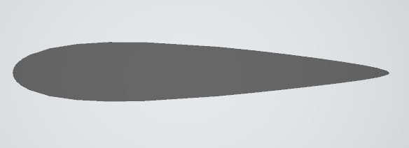

HydroWorld Outlook Posted January 30, 2023 Posted January 30, 2023 (edited) Thank you so much for starting this discussion. I will add my proposals here. Although such parts would be a bit more specialized than others mentioned here, I strongly believe that we need some more rotor and propeller blades added to the LEGO Technic building system. I know we already have the 89509 fan blades as well as the 65422 and 99013 helicopter blades for large propellers, but these two existing pieces alone do not serve our needs well for building air, water, and wind/fan-powered vehicles that use ducted-fan or coaxial propeller systems; the 89609 fan blades are too small and are only produced in one direction, while the 65422 and 99013 helicopter blades have surfaces that are way too thin. Additionally, the helicopter blades cannot create air unless they are securely fastened to the hub at an angle, which is very difficult to accomplish with Technic pieces without the risk of centrifugal force pulling the entire assembly apart, especially for variable-pitch systems. To fix this issue, my proposal is to produce new propeller blades that are wider and more aerodynamic (preferably with leading and trailing edges), as well as new rotor hub elements that allow these blades to swivel or remain stationary (depending on whether or not the propeller is fixed- or variable-pitch) while still keeping them fastened to the hub. The propeller blades themselves should be made in different sizes (to allow for different sizes of vehicles) and designed with neutral, symmetrical airfoils, like the one displayed in the attached image, to allow for use of the same part in both clockwise and counterclockwise rotational directions. This will save on cost when producing the new rotor blade, because only one new element for each size rotor will have to be fabricated rather than two blades exclusively optimized for different directions of rotation. Pin or axle holes on the flat blade tips would also allow a ring to be constructed around the blades to reinforce them while rotating or drive them from the outside, if found necessary. Additionally, the blades should have connectors with circular protrusions that fit in the circular grooves of the propeller hub, as well as axles that allow bevel gears to be mounted inside the hub for variable-pitch systems. This would mean that the hubs would have to be produced in two halves: one for the bottom and one for the top, so that the pitch-changing mechanism would be secured inside the hub with the protruding ends of the rotor blades. This would likely mean producing the propeller hubs with central pin holes rather than axle holes, so that the axle controlling blade pitch could rotate freely for variable-pitch propellers. In that case, driving the propeller assembly itself would would require a standard turntable to connect the rotating blade assembly with the vehicle's static structure around the propeller pitch control axle. For fixed-pitch propellers, the structure built inside the rotor hub would be far simpler, as securing the blades would only require using axle connectors and axle pins to lock the blades to the hub. By securely fastening the blades into the propeller hub, the propeller can operate at much higher rotation speeds without the risk of centrifugal force disintegrating the entire assembly and injuring someone who may be standing nearby when the model is turned on. A possible alternative to bevel gearing would be to provide circular "swashplate" pieces (kind of like mushroom-shaped elements) that connect around the central drive axle and are two studs smaller in diameter than the propeller hub itself. The mushroom elements could have bars extending from their bases that allow them to be reciprocated by either pneumatic cylinders or linear actuators. This system would allow the propeller hub and blades to rotate around the mushroom swashplates, while the mushroom pieces themselves remain stationary with the rest of the build. Unfortunately, the propeller hubs themselves are the biggest catch because different molds of them will have to be fabricated for different numbers of blades. For example, if you need a large 9-blade propeller for let's say, a 1:4 scale model of the Vonmercier EV Sports Hovercraft, you will need a propeller hub that has 9 socket attachments for 9 rotor blades. Or if you're building even bigger like me and you need an even larger 15-blade propeller for a 1:3 scale model of the GE9X, then you will need a larger diameter rotor hub with 15 blade sockets. I know it all sounds a bit complicated, and I understand that such parts may never be feasible, but I strongly believe that adding such parts to our inventory will increase the flexibility and efficiency possible when constructing aircraft, watercraft, and other propeller-powered vehicles with the LEGO Technic building system. Edited January 30, 2023 by HydroWorld Outlook Quote

Davidz90 Posted January 30, 2023 Posted January 30, 2023 2 hours ago, HydroWorld Outlook said: I know it all sounds a bit complicated, and I understand that such parts may never be feasible, but I strongly believe that adding such parts to our inventory will increase the flexibility and efficiency possible when constructing aircraft, watercraft, and other propeller-powered vehicles with the LEGO Technic building system Yes to this, with one caveat: at the small scale/speed Lego models are operating, typical airplane-like profile as depicted is not optimal. Very thin, curved surfaces (like in first airplanes such as Wright flyer or small birds) are better. If symmetrical profile is used (for reasons you described), a flat, thin plate may still be better than "proper" airfoil, but overall zero curvature profile all the way from blade tip to root would severely hurt performance. Quote
