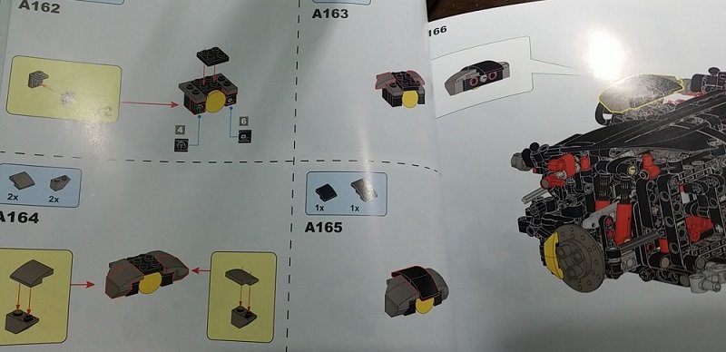

I’m just getting started building this set but then I heard about the fixes that were available in the two instruction manuals. Is there any pdfs out there with these fixes before I start? It’s too bad that CADA does not send each person who buys this set or any set a pdf of the fixes needed to complete one of these models. Thanks

At the beginnig, a Cada Stand alone part is used to connect to black 44809 connectors. According to the pictures on page one, I identify it is replaced in the Lego Version by 2x 65487, 2x 24326 and 1x32034.
