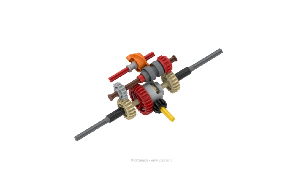

  4. And finally, new function! Rear differential with automatic locking in case of diagonal misalignment of the rear axle. Significantly increased off-road performance of the model will make you happy! The locking mechanism prevents loss of grip during diagonal hanging. The mechanism uses an orange wave shift clutch. The idea was adopted from idea of @Madoca 1977 . The rear axle design can also be used with older type differentials. In addition, you can build a simple and reliable old axle without a lock (but with a new differential), in case you need simple construction.

I like the auto diff-lock especially, nice idea and simple to implement, wonder how it actually performs in practise. I guess the lock does not turn full 90 degrees even at max articulation, but as far as I see, the orange selector is a bit already turned in neutral position as well. So I guess it's enough for it to turn a bit more to lock in, but maybe not fully? Doesn't it click when it's in kind of a half locked position when half articulated for example? Though it may be still be better than having completely open diff.
