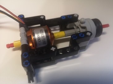

Krxlion Posted March 14, 2023 Posted March 14, 2023 This topic was raised due to our recent discussion with @Daniel-99 and @FriedlS, thus can be used to discuss ways of implementing brushless motors to our lego technic creations. We may also speak about other modifications that surely comes with implementing brushless motors like transmitters, receivers, ESCs, ball bearings, printed parts, etc. To start of, I want to get everyone a picture what we need to power our models with brushless motors: Brushless motor - for example A2212 1000KV 2-3s (A2212 - meaning model type and dimensions, 1000KV - how many turns does motor make when we power it with 1 volt , 2-3s - which type of battery does motor support). Transmitter - for example DumboRC X6FG (good starting transmitter that often comes with suitable receiver, which supports gyro function - it helps the model go in straight line using countersteering). Receiver - like mentioned above. ESC - heart of brushless setup. Think of it as lego technic hub that you connect all motors and receiver to it. The ESC must be bidirectional, usually for mentioned above motor 30-35A should be enough. You may go with SurpassHobby 35A ESC. Servomotor - GeekServo, simple, does it job and is easy to implement in lego models due to pin holes in it. Battery - usually we can choose between 2s and 3s. Second option is more powerful but often simply bigger. My choose was GensAce LiPo 1800mAh 3s 11.1V 45C, but I find it now too big. Battery charger - for example iMAXrc B3. It is cheap and simply does the job, but you can get a better one, suited exactly to your battery capacity and number of cells. If you have any doubts what to choose or how to start, feel free to ask, that is especially the case why this topic was raised. There are some things that you need pay attention one, like matching connection plugs of your ESC and battery, how to transfer RPMs from motor's shaft to lego gears, how do you plan to hold your motor in lego model (usually screw the motor to the liftarm using M2 or M3 bolts). Just to not leave this topic without any questions or discussion I want to ask mentioned above guys few more things: 1. @FriedlS you mentioned one of previous posts that you are using carbon axles, may I ask where do they come from? 2. @Daniel-99 are those housing of A2212 brushless motors are available as printable files so I can try to print them on my own? 3. Do you guys know what other cool brushless motors we may use in our setups? 4. @FriedlS do you know the dimensions of those ball bearings that you've been using in your recent model? Maybe we can fit them in technic liftarms or frames if we would additionally drill slightly bigger holes in them? Quote

Krxlion Posted March 16, 2023 Author Posted March 16, 2023 (edited) Currently my model has THIS way of transfering power from the motor to lego model. I find it more "clean", I do not like mixing my bricks with superglue or anything of that sort, haha. You may take a look at other videos of this person channel, they are quite usefull for brushless enthusiasts like us. Edited March 16, 2023 by Krxlion Quote

Krxlion Posted April 26, 2023 Author Posted April 26, 2023 Hi guys, I just wanted to share with you the concept of using A2212 Brushless motor to drive front and back axles at the same time. Link to GALLERY of few photos, so you can see the whole concept and understand what I will further say. In this case the two yellow 2L axle connectors are driven by this single A2212 BL motor. This is done due to slight move of the shaft to the back. I needed to glue them in place though and slightly sand one of them down, so they now fit exactly to Lego stud diameters perfectly (7 stud long whole setup from one yellow axle connector to another). I must say though that I am bit disapointed by the perfomance. In my previous MOC - Trophic, I was using different BL motor and it could handle two driven axles no problem on full load. In case of this setup, first I tested it without gearing (by planetary hub you see above) and it couldn't rotate ONLY front wheels and without load on them. After that I attached the gear reduction you see (planetary hub) and tested it on front axle. The result was okay, output speed is not compared to "Trophic" MOC though, if I would guess. What I wanted to achieve is a small motor setup, working already on both axles and without need of further reductions (except those in differentials) but this concept fails me on that. I will keep you guys posted and If you have any suggestions or simply want to share something regardin our topic, please feel free. Quote
