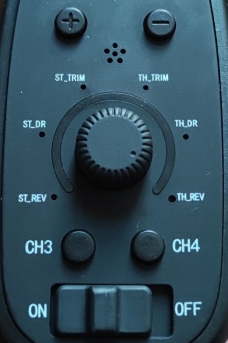

Brano Posted January 11, 2024 Posted January 11, 2024 Hello! I would like to ask I bought geek servo, 2s brushed esc, 2s battery, rc tx/rx And I am not able to controll motor and servo together (really strange behaviour) please check video and advice. I am new to rc components but not to LEGO. Am I missing something? Thank you for you time and advises. Quote
Ryokeen Posted January 12, 2024 Posted January 12, 2024 @Brano First i would try to switch channels, just to see if there is anything wrong with the receiver. Then you can check the manual of your reiceiver/transmitter, as some need to set endpositions for an esc. Then there is the possibility of a faulty esc. Might want to post which esc you use ? Quote
Brano Posted January 12, 2024 Posted January 12, 2024 (edited) @Ryokeen esc is A2 30A ESC Motor Speed RC ESC 2KHz Forward Reverse Brush https://a.aliexpress.com/_EyDb5kD I tried 3different(cheap) esc and behaviour very similar... I will try to check options on rx/tx(options are st_rev/th_rev, st_dr/th_dr, st_trim/th_trim) Also i noticed when i turn servo to left/right -> xl lego motor beeps 5times (via pwm?) Thank you Edited January 12, 2024 by Brano Quote

Ryokeen Posted January 12, 2024 Posted January 12, 2024 @Brano rly weird. As you switched motors, esc and servo, the only constant is the transmitter and receiver. What i've noticed is that first if you use throttle the esc lights up so it get's a signal. After you used the servo, it does not or get random signals. I once had a similar behavior when i used the wrong channel on the receiver. I had a simple power switch attached that can be switched with a servo signal. It behaved very randomly cause i had it on a channel on the receiver that was not actually in use on my transmitter(6channel receiver, 4 channel transmitter). So that or some transmitters have mix modes for tracked vehicles where chan1(throttle) and chan2(steering) are mixed to drive 2 esc. Maybe check if your transmitter supports that and has that enables. Else i could only guess that the transmitter/receiver pair is faulty. Quote

Brano Posted January 13, 2024 Posted January 13, 2024 @Ryokeen I bought tx/rx as a bundle(new) 4ch rx and tx. According to website it should support mixed channels but i didnt receive user manual... I have tried every option but without success @oracid new video uploaded Quote

Ryokeen Posted January 13, 2024 Posted January 13, 2024 (edited) @Brano honestly at this point i think the transmitter/receiver is faulty. Also the ALI-express site seems to contain wrong information. The video you posted states that the transmitter uses AFHSD and not like on ALI FHSS. Also ali states that the receiver got a gyro in it and states there is an lcd display. Sooo kinda sus. Anyways if it got a gyro in it, that can cause issues as some gyro systems not only correct the steering but also the throttle. And if the gyro is faulty, then yea. I would suggest filling a complain on ALI and get a new set, i mean you swapped everything except the transmitter and receiver and checked the manuals. If it still doesn't work chances are high that those parts are faulty. Else you could try out turning off the break function on the esc(the small soldered on lever), but i doubt that will fix anything Edited January 13, 2024 by Ryokeen Quote
Brano Posted January 13, 2024 Posted January 13, 2024 @Ryokeen yes i tried break switch... No success. I ordered brushless esc and also motor i will try this maybe it will work. If not next step will be new rx/tx 😭 Quote
