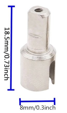

killerfrost Posted April 26, 2024 Posted April 26, 2024 (edited) I’m not above modifying parts that are already aftermarket to make something work. I’ve already been able to fit the diff cup into the wheel hub. I can post pictures when I get home from work. this is the part I got to fit with minimal modification. https://a.co/d/7XBGO4E Edited April 26, 2024 by killerfrost Quote
