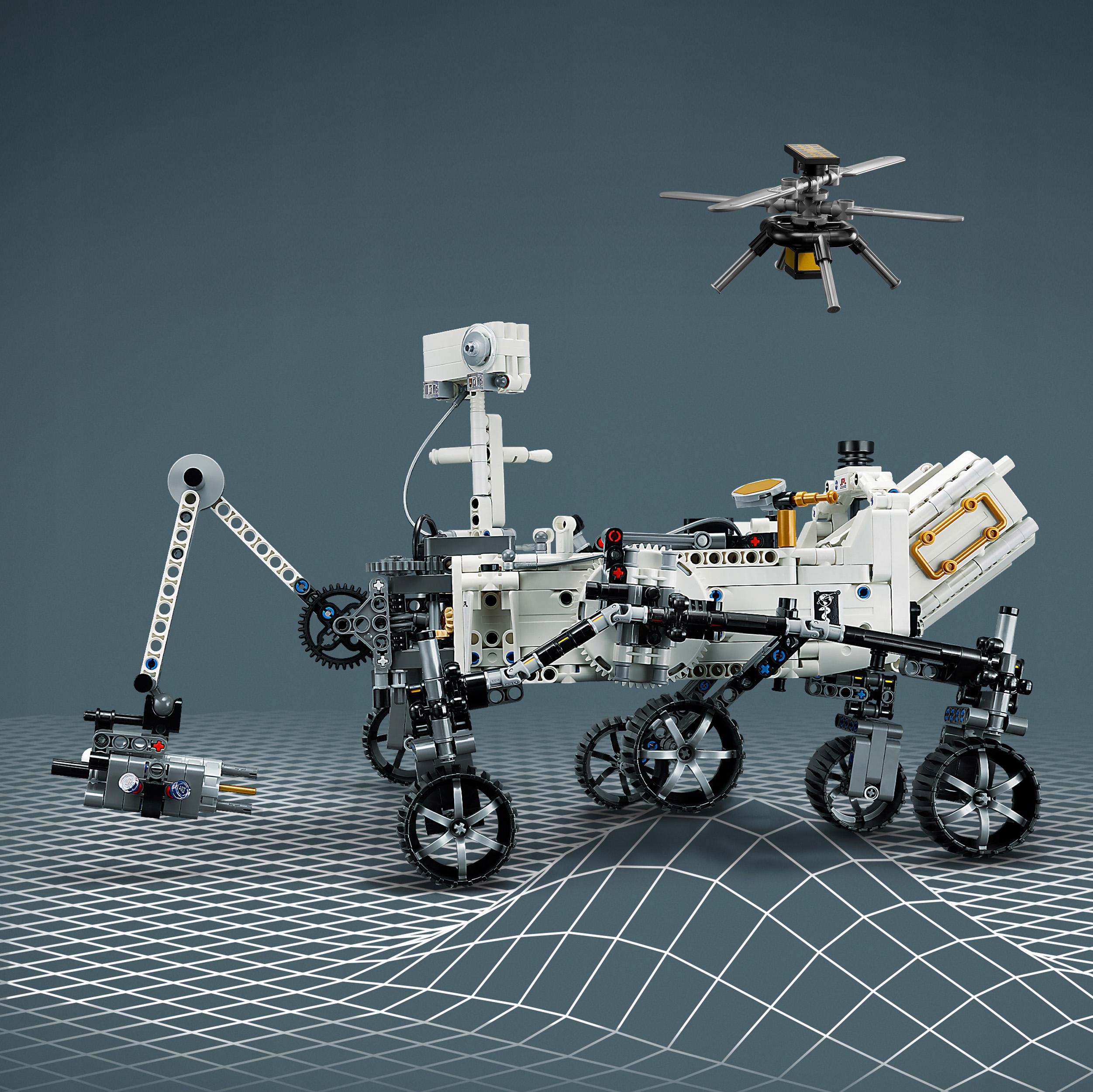

gyenesvi Posted May 2, 2023 Posted May 2, 2023 This seems pretty interestinng technically with the proper suspension and the steering modes. I always wanted to build such a suspension! The steering modes are shown to be selected by the lever in the middle of the body. So does that mean the front and rear wheels need to be actuated independently and the big turntables are used such that two functions could be transferred through them? Quote
AVCampos Posted May 2, 2023 Posted May 2, 2023 31 minutes ago, gyenesvi said: So does that mean the front and rear wheels need to be actuated independently and the big turntables are used such that two functions could be transferred through them? No, the mode should change whether the left wheels turn in the same direction as the right wheels, or the opposite. The "turn in place" mode is as shown in the box, whereas the "regular steering" mode works like the 8660 or the 8830. Quote

allanp Posted May 3, 2023 Posted May 3, 2023 (edited) 8 hours ago, gyenesvi said: So does that mean the front and rear wheels need to be actuated independently and the big turntables are used such that two functions could be transferred through them? I was thinking something similar but you don't actually need two functions through the turntable for this. Usually we link the left and right wheels with a steering link, but in the mars rover the wheels are linked front to back, so to swap steering modes all you have to do is swap the direction of rotation through the turntable on one side, because in both steering modes the rear wheel turns opposite to it's front wheel. You would only need two functions through the turntable if it had crab steering which it doesn't. Edited May 3, 2023 by allanp Quote
Akbalder Posted May 3, 2023 Posted May 3, 2023 Is the body of the rover connected to the wheel only using the turn tables? Is it only the balance which prevents the body of the rover to tilt? Quote
allanp Posted May 3, 2023 Posted May 3, 2023 24 minutes ago, Akbalder said: Is the body of the rover connected to the wheel only using the turn tables? Is it only the balance which prevents the body of the rover to tilt? No, there's a stabilizing link across the top of the body also, so rotationally the body should be keep half way between the two turntables. Quote
gyenesvi Posted May 3, 2023 Posted May 3, 2023 10 hours ago, AVCampos said: No, the mode should change whether the left wheels turn in the same direction as the right wheels, or the opposite. 3 hours ago, allanp said: I was thinking something similar but you don't actually need two functions through the turntable for this. Usually we link the left and right wheels with a steering link, but in the mars rover the wheels are linked front to back, so to swap steering modes all you have to do is swap the direction of rotation through the turntable on one side, because in both steering modes the rear wheel turns opposite to it's front wheel. You would only need two functions through the turntable if it had crab steering which it doesn't. Oh, okay, thanks, I get it now, so you only need to switch what the left/right sides are doing wrt each other, and that can happen inside the body, that's nice and simple! Quote
lmdesigner42 Posted May 3, 2023 Posted May 3, 2023 The multiple steering modes is a really cool addition. Is it possible that the 12 tooth gear is connected to an assembly of 3 bevel gears and a bracket, so that rocking the gear back and forth makes the outputs rotate in the same direction, while turning the gear makes them rotate in opposite directions? Rocking the gear would then cause turn-in-place, while rotating it would cause normal steer. Quote

pleegwat Posted May 4, 2023 Posted May 4, 2023 For the steering mode, consider that the 'turn in place' mode really only works for a single steering position. Quote
aeh5040 Posted May 4, 2023 Posted May 4, 2023 (edited) On 5/3/2023 at 8:55 PM, lmdesigner42 said: The multiple steering modes is a really cool addition. Is it possible that the 12 tooth gear is connected to an assembly of 3 bevel gears and a bracket, so that rocking the gear back and forth makes the outputs rotate in the same direction, while turning the gear makes them rotate in opposite directions? Rocking the gear would then cause turn-in-place, while rotating it would cause normal steer. 4 hours ago, pleegwat said: For the steering mode, consider that the 'turn in place' mode really only works for a single steering position. Right. So perhaps "rocking" the lever into one position forces the two sides into their extreme positions for turn-in-place mode, with no rotation of the gear possible, while with the lever in the other position we can rotate the gear for normal steering. That would be a nice control mechanism! Edited May 4, 2023 by aeh5040 Quote
