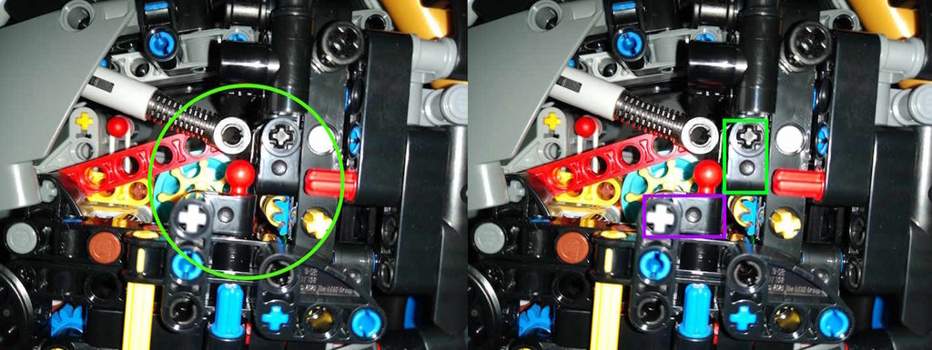

Daan1234 Posted September 18, 2023 Posted September 18, 2023 On 9/15/2023 at 11:41 PM, williamyzfr1 said: It doesn't get stuck for any other gear change so I don't think it would change for 3rd back to 2nd but thanks for the reply. UPDATE: Strangely 24 hours later ALL the gearchanges are performing perfectly ???? If you look closely at the gear indicator (you have to remove fairing to see it properly), you will observe that it can only get stuck between 2nd and 3rd gear. See photo below. For some reason, they placed the gear indicator dangerously close to some part of the frame. There is an extremely small margin between both black parts, and sometimes I can see them touching. This only happens between 2nd and 3rd. Quote
