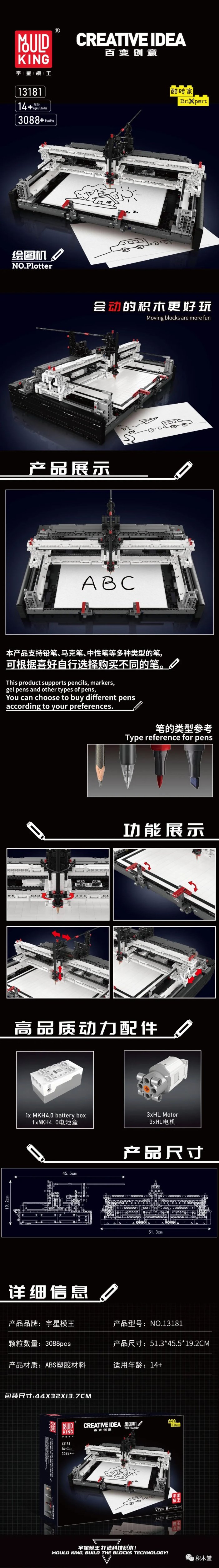

Sokolov Edward Posted October 11, 2023 Posted October 11, 2023 Mould King recently released its 13181 pen plotter. It uses 3 conventional L-motors and a Bluetooth remote control unit. Assembly instructions are available in the manufacturer's Facebook thread. Quote

ord Posted October 12, 2023 Posted October 12, 2023 20 hours ago, Sokolov Edward said: Mould King recently released its 13181 pen plotter. Hm, it looks awfully similar to my plotter design: On 10/11/2023 at 3:19 PM, dr_spock said: Maybe something with CNC process steps to draw out the image file? -Have the computer convert the image file to a vector based image. -Generate GCODE drawing paths from the vector image. -Send to the GCODE to EV3. -Have the EV3 parse the GCODE to command the servo motors in moving the pen on a piece of paper. This is basically how I did it @Knight3, except with a Robot Inventor hub rather than EV3. There is a lot of detail in the WIP thread here (including the python program I wrote in pybricks): I highly recommend the command-line tool "vpype" and a plugin for it called "vpype-gcode". They are purpose built for plotter vector graphics, and with them you can convert any .svg file into gcode, which you then just paste into a program and run it (feel free to use/copy mine). Quote
Sokolov Edward Posted October 12, 2023 Posted October 12, 2023 (edited) 7 hours ago, ord said: Hm, it looks awfully similar to my plotter design: This one is simpler than yours in terms of controls, which are the same as those of a regular Lego car. And the design and principle of operation of all flatbed plotters is almost the same. Edited October 12, 2023 by Sokolov Edward Quote
