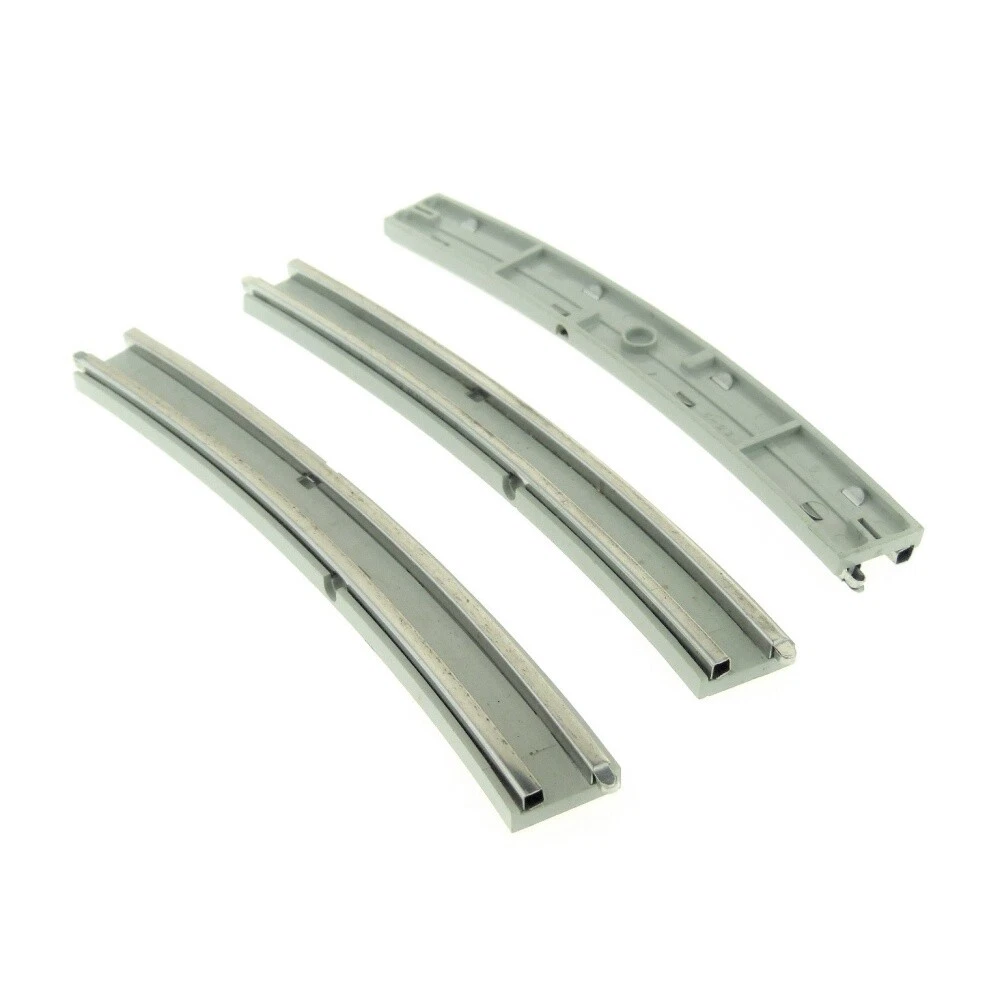

Thank you for joining EB and welcome to Train Tech. It is basically the same idea so I merged the two topics. The 9V montor picks up the power via the wheels. The 12V motor has those 'springed' pickups that connect in a flexible way to the additional middle track of course. See here a possible way to do it:

I don't think the 12V third rails fit on 9V curves.
I'm pretty sure the geometry of the 9v system was designed to be as backward compatible as possible. I don't have any of the 12 power rails, but I know that the curved power rails only have a few stops on the underside. Still, the switches of one form are completely incompatible with the trains of the other form. So you if they are compatible, you could only build fully compatible layouts without switches.
Dude, I literally said nothing about the 12v third rail. I thought of a way to link the 12v power cables directly to the 9v track, without the power rail.
