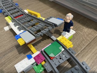

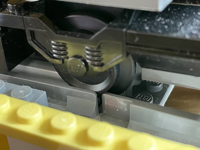

faph Posted April 21, 2024 Author Posted April 21, 2024 (edited) Extensive real-life testing over the weekend threw up an issue: When spacing tracks a stud apart, train wheels are prone to dropping on the inside of the split rail connections. This was even more of an issue when I was connecting the track with tiles-as-rails since that would have an additional half-stud gap. It doesn’t cause derailment but with the tiles-as-track it wouldn’t be a comfy ride for passengers either! So I’m going back to spacing official track a stud apart - the ride is just about smooth enough in that case. I will accept that I will be 2 studs out of grid :( And yes @Shiva I have now placed the pivot point a plate higher relative to the track and this does solve the collision issue nicely. Thanks for the tip! Edited April 21, 2024 by faph Quote

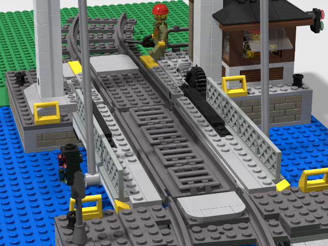

faph Posted April 22, 2024 Author Posted April 22, 2024 This is what I've got now: Track now 1 plate lower compared with pivot point. I am also needing to curve and incline up to the bridge. This means at this end of the bridge I do need a raised area between the rails otherwise light train cars might derail at the half stud spacing between the track parts. Quote
zephyr1934 Posted April 23, 2024 Posted April 23, 2024 On 4/19/2024 at 12:04 PM, faph said: Our daughter needs to be able to place minifigs anywhere! Ah, design constraints to satisfy the consumer... (grin). I do like your brick built solutions and there might be a way to either fill the gap at the end of the rail or use the tiles to nudge the wheels over, but at some point it is pragmatic to just get to playing. If the 2 stud offset ever bothers you you can probably get fractional track lengths from TrixBrix or similar to bring it back into grid. 17 hours ago, faph said: Track now 1 plate lower compared with pivot point. The rule of thumb I've heard and live by is to have at least one straight segment between a curve and a switch to prevent trains from "picking the switch," i.e., derail. The curve right into the gap might give you a similar problem on the near side of the above photo. At any rate the design looks great Quote
faph Posted April 23, 2024 Author Posted April 23, 2024 3 hours ago, zephyr1934 said: The curve right into the gap might give you a similar problem on the near side of the above photo. Exactly, it does. But the raised “island” between the rails solves it! Experiments signed off by Statler himself: No more design changes allowed ;) Quote

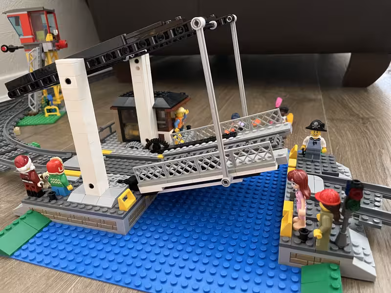

faph Posted July 2, 2024 Author Posted July 2, 2024 (edited) It has been built! Photos to follow soon. In real-life the bridge deck was not sufficiently rigid. It wasn't too weak as such, but without any load it warped a little which caused the bridge to remain in a slightly open position at the far end. Fixed this with 1 layer of additional plates and cross-supports underneath the deck. To my liking, there's also a little bit too much gear backlash. Not a major deal though so I will probably not do anything about it. The contra-weight isn't quite sufficient to balance the bridge deck, but that's actually quite a good thing as the bridge will stay closed much better with a bit of extra downward force from its own weight. The gearing ratio is just perfect. Other that than, turned out pretty much as designed. The track transitions are as per proof-of-concept: no derailings, but drivers should watch their cups of tea :) Edited July 2, 2024 by faph Quote

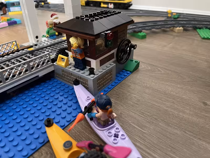

faph Posted July 2, 2024 Author Posted July 2, 2024 Thanks @SD100! So far the off grid is not an issue for me. Contra weight being lifted in place... Freight train crossing nicely: Kayakers patiently waiting... The random coloured plates under the bridge deck are the added stiffness requires to keep the bridge deck straight. Will need the railway maintenance people to re-paint this in black and grey... Quote

Feuer Zug Posted July 3, 2024 Posted July 3, 2024 Nicely done. Having the span be able to lift and fall without having to realign the track each time is great engineering. Quote

LEGO Train 12 Volts Posted July 3, 2024 Posted July 3, 2024 What a pleasure to see the bridge in work ... the passage of the canoes is the icing on the cake! Quote
