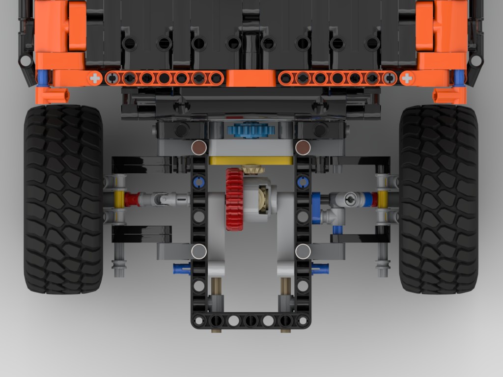

Just out of curiosity, can you show the custom CV joint that you built?

Well. Maybe I'll paste a picture of the entire drive system. You can see the CV joint there. It's really nothing special but it works.
By the way, an interesting fact. I was so keen to get a realistic Hummer clearance that the drive system has a clear friction of the CJ joints during assembly. After building the entire model, when the full weight of the Hummer loads the suspension, the drive works smoothly :D

Thanks, nice little joint, though it looks a bit fragile, even for a manual model. Couldn't it have been built symmetric, by using two of the blue 2L thin liftarms on both ends?
Well that's a very good question. I put this CV Joint together like this because it's solid enough for the manual version. In addition, at the stage when I built the chassis I didn't want to use the useful connectors. Now I checked and I see that I could have made it symmetrically. As I mentioned earlier it wasn't necessary because it's quite solid. I also assumed that during the build if someone wanted to make the RC version they would change it to the original CV Joint anyway :)
