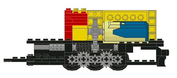

I'm a little dissapointed that you went with Swoofty's solution to powering the wheels, as you could in theory have the main drivers as propulsion wheels, and therefore have the locomotive itself propel the train, with the battery-box and receiver neatly packed into the tender. Other than that, it's an impressive feat of LEGO engineering.
It is nonetheless nice to see people experiment with this. I've myself have been experimenting and theorising about it in MLCad, and ended up with a small dual-shunter (master and slave unit, attachment shows mock-up of master) with a single motor powering the two units through universal joints between them (the axle leading out of the locomotive goes to the slave unit). The master unit would be carrying the motor, with the slave unit the receiver and (rechargable) batteries. The result: Six powered axles, 2cm/sec top speed and 29Ncm of torque.

I didn't power the engine through the drivers because there was no elegant way to hide the motor with the way the boiler is constructed. And I hate seeing motors, gears, and other drive train parts poking out and marring the looks of a model. Besides this works well and I'm happy with the results.
