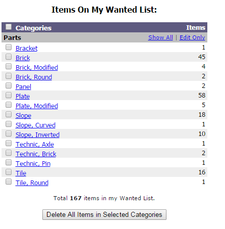

Bartolomeo404 Posted December 14, 2015 Posted December 14, 2015 (edited) hi i have a problem, i've created an ldd awp|asiimow (is not mine but i wont to create it) but when i load on LDD Manager (the all number of bricks is 878) it says :"brick count [878], unique bricks [167]", i have done all passages and i have uploaded the xml on bricklink, but bricklink says i selected only 167 items . can you help me? thanks (AWP ASIMOV.lxfi add a copy of the awp asiimow on description) please i neet it for christmas Edited December 14, 2015 by Bartolomeo404 Quote
Superkalle Posted December 14, 2015 Author Posted December 14, 2015 I'm not sure what the problem is. Can you explain what you see in Bricklink. Does not the Items column add up to 878 bricks? Or does it only add up to 167? EDIT: I just imported your file into LDD Manager and then uploaded it to a Wanted List, and it looks all good, see attached image. PS: Is it going to be a toy? Why don't you make the scope hollow so you can see through? Quote
Bartolomeo404 Posted December 14, 2015 Posted December 14, 2015 (edited) thanks because i'm new and i can't uderstand but i can now (sorry for my english) (for the scope)and because i have a few time tanks again Edited December 14, 2015 by Bartolomeo404 Quote
DawnTreader Posted December 15, 2015 Posted December 15, 2015 Your model has a total of 878 bricks but there are only 167 different bricks. So you might have 17 tiles but there is 1 round one and 16 tile square. (or whatever type they are). Total Quantity and Total kind of bricks are 2 different things. Quote

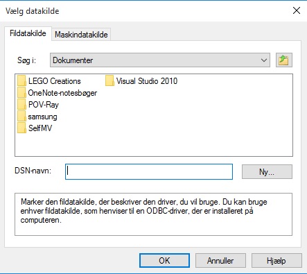

snakebyte Posted December 18, 2015 Posted December 18, 2015 Hi I am having ODBC problems with my LDD Manager. When I try to use thumbnails it wants me to choose a datasource . I can see others have the same problem but it doesn't seem to be fix for this? I am using ldd 4.3.8 version 1564.2 And LDDManager 1.25 for LDD 4.3.8 Office is 2013 32 bit. Has anyone found a solution to fix the ODBC problem? Quote
Superkalle Posted December 18, 2015 Author Posted December 18, 2015 Hi snakebyte. I haven't heard about any ODBC issue before (or maybe I just forgot ) Unfortunately I don't know what the problem can be right of the bat. Everything in LDD Manager is "self contained", i.e. there are no references to any data sources outside the program. Can you please post more exactly what the error message is and when you get (in which window) and I'll try to investigate. Quote
snakebyte Posted December 18, 2015 Posted December 18, 2015 I have attached 3 files. Window1.jpg: When I have chosen a model in my library and choose "Show brick thumbnail" the dialog in Windows2.jpg shows up. Sorry - it is in danish. When I cancel the window in Windows in windows3.jpg shows up. I hope this helps. Quote
Superkalle Posted December 20, 2015 Author Posted December 20, 2015 No problem with the Danish Jeg forstår nokk dansk rimligt godt. I've had a look. In the code it tries to make a connection (Application.CurrentProject.Connection). Why it then throws you the dialog to chose a data source I'm not sure about. I did some googling on it, and found this, so my best recommendation is that you make a repair of your Office 2013, so that necessary files are re-installed/re-registered? You shouldn't need to download anything - just a repair installation should do it. Another thing to do can be to try LDDManager on another computer with Office/Access (32-bit) and see if it works there. Quote
snakebyte Posted December 20, 2015 Posted December 20, 2015 Hi Superkalle Tak for hjælpen :) I have tried to reinstall my office, but i still get the same error. I uninstalled, restarted, and installed again but still the same error. I then tried to install office 2010 x86 on the computer, so that I both have office 2013 x86 and office 2010 x86 on the same computer. That seems to have fixed the problem. Quote
Superkalle Posted December 20, 2015 Author Posted December 20, 2015 Hi Superkalle Tak for hjælpen :) I have tried to reinstall my office, but i still get the same error. I uninstalled, restarted, and installed again but still the same error. I then tried to install office 2010 x86 on the computer, so that I both have office 2013 x86 and office 2010 x86 on the same computer. That seems to have fixed the problem. OK, good that it got solved, but it shouldn't really be necessary to install Office 2010. Sometimes installing another Microsoft product (e.g. One-note) will mess up the installation for existing Office installations. Maybe this was the case? Quote
snakebyte Posted December 20, 2015 Posted December 20, 2015 OK, good that it got solved, but it shouldn't really be necessary to install Office 2010. Sometimes installing another Microsoft product (e.g. One-note) will mess up the installation for existing Office installations. Maybe this was the case? Perhaps - When installing I allways choose a complete install of office. I believe that includes - among other things - onenote. It is a pro plus version in both 2010 and 2013 if I remember correctly. Quote
Superkalle Posted December 20, 2015 Author Posted December 20, 2015 Perhaps - When installing I allways choose a complete install of office. I believe that includes - among other things - onenote. It is a pro plus version in both 2010 and 2013 if I remember correctly. Oh, OK. But I didn't mean products that are in the Office installation, but later installations that somehow overwrite the Office files. Could be even non-MS products. Quote
