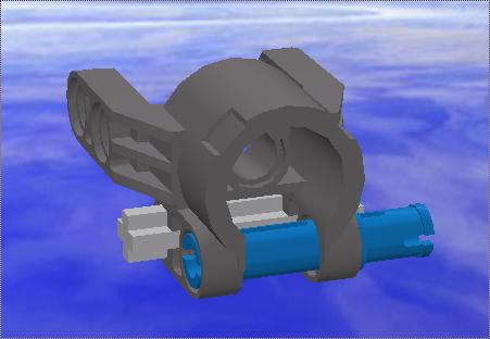

CP5670 Posted July 9, 2010 Posted July 9, 2010 I still don't understand what you guys are talking about with the Blue pin and what is so wrong with what they did. The blue pin is sitting halfway between the yellow beam, so it hasn't actually clicked into place there. This means that it's permanently in compression, so it will get deformed over time. This could have been fixed by using two half-width liftarms stacked on each other, but the full-width beam has no notch inside the hole for the pin to lock onto. Quote
TechnicJuan Posted July 9, 2010 Posted July 9, 2010 (edited) The blue pin is sitting halfway between the yellow beam, so it hasn't actually clicked into place there. This means that it's permanently in compression, so it will get deformed over time. This could have been fixed by using two half-width liftarms stacked on each other, but the full-width beam has no notch inside the hole for the pin to lock onto. The pin in the actuator base? Isn't the pin clicked onto the other side of the Gray actuator piece? I have this same set up right in front of me and the pin is clicked on the other side just fine. It doesn't look like it is sitting halfway through to me. Here is a photo where you can plainly see the pin clicked the whole way through. Or are you guys talking about something else? Edited July 9, 2010 by TechnicJuan Quote
mortenm Posted July 9, 2010 Posted July 9, 2010 The pin in the actuator base? Isn't the pin clicked onto the other side of the Gray actuator piece? I have this same set up right in front of me and the pin is clicked on the other side just fine. It doesn't look like it is sitting halfway through to me. Here is a photo where you can plainly see the pin clicked the whole way through. Or are you guys talking about something else? i see what you mean, it doesnt fit right in the way its mounted on this picture - on the double-length og the blue pin, there's a (i dont know what you call it in english :s - just like the one in each end, which clicks, when it fits correctly) and this is sitting in the middel of the yellow liftarm, which means that its compressed all the time, like cp5670 says. it would be the same if you push a pin only halfway through a liftarm - it doesnt click. i hope this make sence, my english isnt the best :s Quote

eMHa Posted July 10, 2010 Posted July 10, 2010 (edited) i see what you mean, it doesnt fit right in the way its mounted on this picture - on the double-length og the blue pin, there's a (i dont know what you call it in english :s - just like the one in each end, which clicks, when it fits correctly) and this is sitting in the middel of the yellow liftarm, which means that its compressed all the time, like cp5670 says. it would be the same if you push a pin only halfway through a liftarm - it doesnt click. i hope this make sence, my english isnt the best :s I don't see any problem, see attached image, created with LDD. The technic pin is displaced about 1/2 stud, but it does fit. Have I overseen something? Edited July 10, 2010 by eMHa Quote
mahjqa Posted July 10, 2010 Posted July 10, 2010 The point is that the three-studs long blue technic pin is compressed in the middle. If this is a pin: _ ________| |________ ________ | | | | | > | | | < |________| |________|________| |_| | | Here If that part is compressed for a long time, the plastic may not spring back later, because it's been permanenty damaged. Quote
eMHa Posted July 10, 2010 Posted July 10, 2010 The point is that the three-studs long blue technic pin is compressed in the middle. If this is a pin: _ ________| |________ ________ | | | | | > | | | < |________| |________|________| |_| | | Here If that part is compressed for a long time, the plastic may not spring back later, because it's been permanenty damaged. Ah, now I see. LDD also won't let me connect a beam to this. Thank you. Quote

TechnicJuan Posted July 10, 2010 Posted July 10, 2010 There are many other pieces you could have said the same thing about at one point, but which are difficult/expensive to come by today. You never know how long a given piece will remain in production and thus be "inconsequential." I'll just replace it with an equivalent legal assembly, which I have done in a few other sets in the past. This could be simply remedied with a 3L Axle with stop/stud, Axle connector, 3L Axle with stop/stud. Quote
