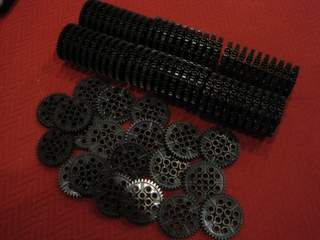

nychase Posted January 25, 2013 Posted January 25, 2013 (edited) - Black 40T gears - there are 23 on Bricklink, ranging from EUR 2 to EUR 8. No store has more than two. I went grey, with a view I know where 80 of the worlds supply are. Plus of course the 8 for my own JS220. Edited January 25, 2013 by nychase Quote
Blakbird Posted January 25, 2013 Posted January 25, 2013 Blackbird whats ur opinion on the ultimate 8043? Or do u prefer the non rc pneumatic machine? I didn't build the ultimate 8043, I built the Zorex excavator. Both it and the JS220 are really fun to use. I still prefer the realism of pneumatics though.. I know where 80 of the worlds supply are. Cruel. Quote
EdmanZA Posted January 25, 2013 Posted January 25, 2013 The yellow tubing running up the main boom needs to be yellow, but almost everything else is hidden so it doesn't matter. The black tubing for the black railings on top of the superstructure would also need to stay black. I had no trouble finding this, but it could also easily be replaced with any from of black round rod of the same diameter e.g. Evergreen, Plastruct etc. Cruel. I'll second that Quote
