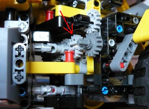

Wow! I also have 8265 but I got it last christmas. I don't had any issues with this.
But I have bought 8297 recently and I have the same issue there! One 16 tooth in the steering system on a technic axle pin is slowly unscrewing while steering.
I've put a technic beam in front of it to prevent it from unscrewing.
I thought it's because I've build the off roader in a rush (three kids waiting that it will be finished :classic: ) and so the steering is not that smooth. But thinking about it again, why should the gear slide down? Only because there's a lot of torque?
Could it be that the gear or the axle pin has changed slightly?
I've never had a problem with 16t gears sliding off axles or axle pins, but 8t's do it all the time. My 16t gears all grip pretty tightly.
The old 16t gears from before my dark ages grip also pretty tightly. But the new ones have much less grip.
To my surprise the 16 tooth gear had HALFWAY worked itself off of the pin from the load caused by normal play with this function so still just enough to still mesh with both other gears (the other side is unable to do this due to placement of 2L friction pin w/ stop that attaches the steering)
Good point. I’ve discovered that my 8265 has the same problem, but on the other side : the 16 tooth gear is pushing the friction pin. If the 16 tooth gear is pushed back in the right position, it slides again slowly when the arm is moved.
I wonder if the new LAs will solve this issue. My 8265 is unpleasant to use, because the movement is rather stiff.
I checked my 8265 and those gears had moved outward very slightly, but not to any significant extent.
Someone actually described seeing a new batch of 16t gears here last year, which are said to have a weak grip on axles. I don't seem to have any of these in my sets, but they might be the cause of the problems people are experiencing.
