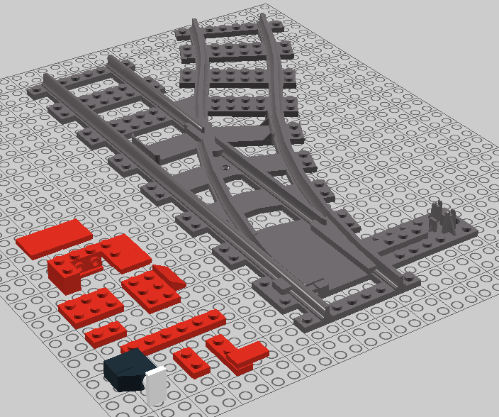

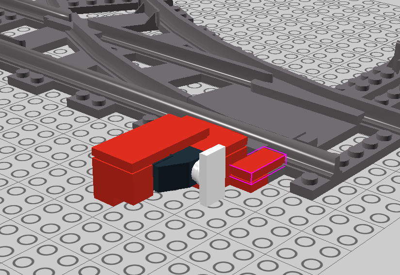

LDD version of the powered switch point:
Design:
http://www.pavsic.com/kocke.si/Smart9V/kretnica1.png
Taken apart:
http://www.pavsic.com/kocke.si/Smart9V/kretnica2.png
(the black "thingy" is the actual size of the servo motor mentioned up there - ok i didn't account for the cables, but that's a minor thing)
I'm thinking of gluing a 1x2 brick / tile at the bottom - vertical position or 2x2 brick / tile at the side - horizontal position.
