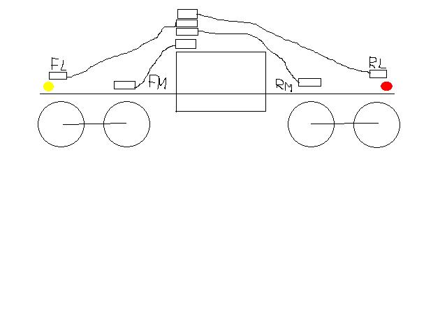

mpec82 Posted March 28, 2011 Posted March 28, 2011 Uhm, a bit confused. If I would like to add a second RC motor to my 7898, i need something else apart another RC motor and the relative wire? How do i have to connect the second motor? Quote
Snapshot Posted March 30, 2011 Posted March 30, 2011 Uhm, a bit confused. If I would like to add a second RC motor to my 7898, i need something else apart another RC motor and the relative wire? How do i have to connect the second motor? No, you just need the motor and wire for RC. It's PF that gives the problems as the connectors cannot be reversed to reverse the direction of the second motor. Quote
mpec82 Posted March 30, 2011 Posted March 30, 2011 No, you just need the motor and wire for RC. It's PF that gives the problems as the connectors cannot be reversed to reverse the direction of the second motor. So i simply connect this way? FM= front motro FL= front light RM= rear motor RL= rear light Quote
