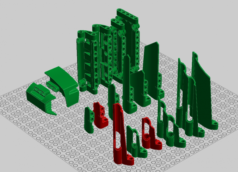

Superkalle Posted October 28, 2014 Author Posted October 28, 2014 I know you are doing your best, thank you for your effort! Thanks and no problem. I just wanted to point out that there are several cases when plates don't connect (like most of the Technic panels) How do you mean "most of". I'd say it's the opposite - most of them have connectivity, see attached image. Quote
mzoli Posted October 28, 2014 Posted October 28, 2014 Thanks and no problem. How do you mean "most of". I'd say it's the opposite - most of them have connectivity, see attached image. Yes, "most of" is not valid. However panels 44352 and 44353 have issues too, these are missing from your picture. Quote
