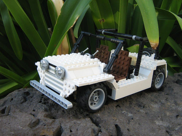

RohanBeckett Posted March 10, 2011 Author Posted March 10, 2011 Well.. I've made some progress! Still not 100% happy with the steering.. It's just got too much slack in it.. and even after I got a Hockey Spring off Bricklink.. it seemed to add friction/drag to one direction of steering... plus of course, the turning circle is crap.. but that's to be expected with front wheel drive. I might build your idea, Zblj, and see if it'll fit into my body work. anyway.. just posting to show a work-in progress: In my original 'hello' post, I showed off a Mini Moke that I'd made as a present for my girlfriend (now wife!) http://www.eurobrick...showtopic=38959 This Easter, we're driving the car 600 km's to a 'Moke Fest'.. probably around 80 vehicles from around Australia meeting up for the long weekend holiday. I'm hoping to have it finished by then, to bring along, and show off! There's some really unusual angles and curves in this little car.. took a bit of experimenting to work out.. a lot of SNOT work too! One day, I might try it in studless.. but for now.. studded is what I build best in! Working Headlights Working Steering wheel Removable Bonnet (same as original car!) PF Remote Controlled Hope to have a mockup engine in here No Suspension, but it's true to the original car - front wheel drive. I think I've improved on the original version! The Real Thing: Quote

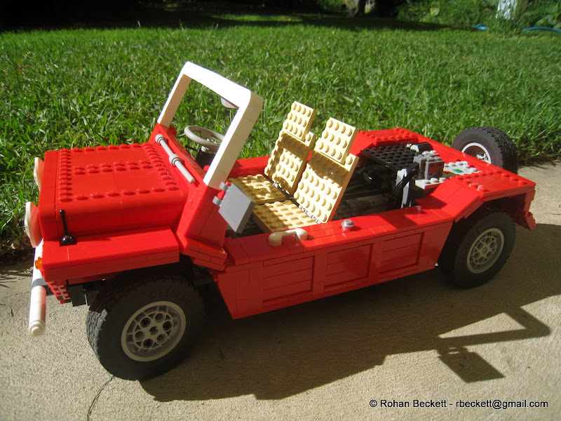

DLuders Posted April 23, 2011 Posted April 23, 2011 (edited) RohanBeckett posted this of his completed Mini Moke II: Edited April 23, 2011 by DLuders Quote
RohanBeckett Posted April 23, 2011 Author Posted April 23, 2011 (edited) Haha! beat me to it! :) My family were originally going to drive 550km's to a 'Mokefest' on this weekend, in Central NSW, Australia... but our real Moke has had more unexpected issues, (electrical, and gearbox shifter) and we couldn't rely on it surviving the trip... We went in 2009, and almost 100 cars turned up... they are expecting 70+ this weekend too I'd spent the last 2-3 months building the Lego one, in anticipation of bringing it along, and showing it off (and maybe scoring a few commission-builds! haha - plenty of enthusiasts there who might want their own Lego Moke!) I've mostly finished it, and I took a few photos/videos, and uploaded them, hoping that a few Moke-friends with wifi up there would be able to show them off to others. Working Front Wheel Drive Working Steering Working Headlights (Gear Lever is the light switch!) As close to scale as I could get! - thanks to Sariel's scaler web-app! Mock up engine Various little details like bonnet clips, wipers, rear view mirrors, dash, and passenger handle I still have a bit of work to do with the back.. I'd like to try and conceal the battery box + motors a bit lower, maybe underneath some rear seats. Compared to other car MOC's the others' make.. it was a bit of a challenge building this - as the Moke in real life has no Chassis - the body *is* the bulk of the frame. and there's no cabin, or boot/trunk to hide PF gear in!! :) I also wanted it to be a true front wheel drive too. I spent a bit of time trying to link the steering wheel in, but both gears and U-joints added too much slack, and since the front wheels have limited steering range, due to the FWD, the steering wheel barely moved at all. Still not 100% happy with the steering/driving speed, but it's definitely limited using those Lego Parts - they are really designed for push-along cars, and have too much friction for motor-driven vehicles. And for another challenge, I tried building the smallest Lego Moke I could: More Pics here: https://picasaweb.go...kett/LegoMokeII OK.. now... to find something else unique to build! :-) Rohan. Edited April 23, 2011 by RohanBeckett Quote
