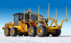

Posted April 5, 201113 yr My new project will involve a forestry machine used to collect fallen timber. I have a nice design for the drive and suspension but im having trouble making a good crane. Does any one have a good crane ideal like the one shown on the model? The link below is the model I plan to build.
